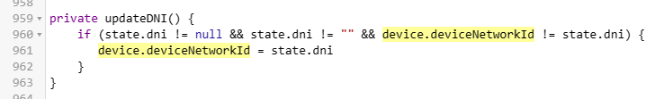

java.lang.IllegalArgumentException: A device with the same device network ID exists, Please use a different DNI on line 961 (method refresh)

Also, I noticed that the DNI is c0a81ef9:0050 (this is the IP address of the controller, plus this strange extension).

I still have to manually enter the IP address. What I've noticed is that the DNI is the hex values of the IP address until I edit the preferences (enter the controller webpage password), then click "Configure" and "Refresh". That all seems to work.
I've notice that after I update the preferences, then the DNI is modified from the IP (hex) to the MAC ID (still hex). Not sure where or why....but this seems to be the problem.
I haven't done anything in a long time on the app or driver. You can try to comment out line 961 and see how it goes. It would at least prevent that error. Comment with a proceeding "//"
