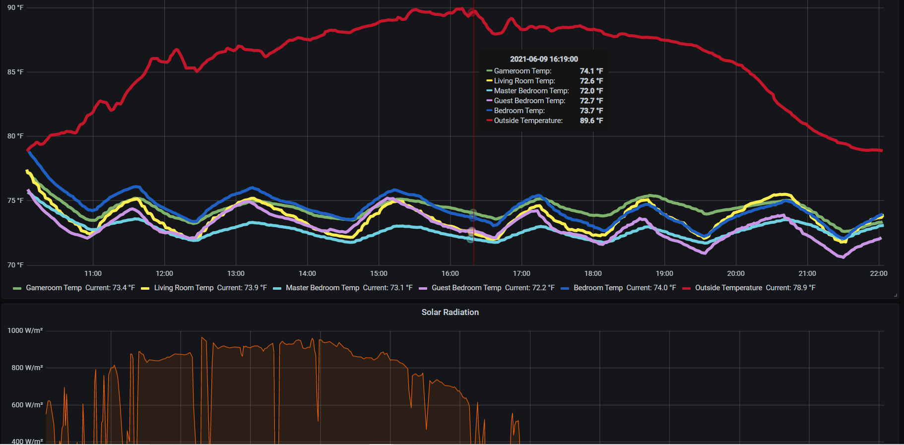

As previously stated: 1983 2000sqft house with 1983 single pane windows and insulation. ZERO trees for blocking the heat gain from sunlight to provide shade Today hit 102 degree heat index and almost full sun the entire day as you can see in the lower chart.
The upper chart shows each of the 5 main rooms temperature average, one room occasionally switched spots with other rooms throughout the day, but NO room was at any time more than 2.1 degree warmer or colder then the hottest to the coldest room.
Zoning is not needed on a single story house, using home automation, temperature averaging, and one time vent adjustments..
