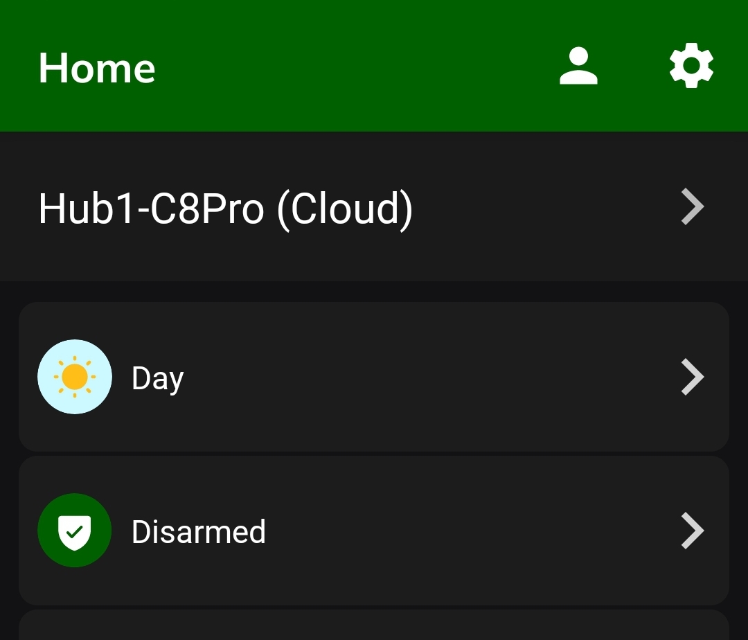

Are you on your local network now? I don't use Android, but in the iOS app, if you go to the "Home" page in the app, it says near the top if you are "Local" or "Cloud" in terms of connection -- if it says "Cloud", then SS will not available. If it says "Local", then you should be able to use SS.
Looks like this in the Android app, though it should say (Local) where it says (Cloud) in my screenshot. (I'm out walking the dogs right now.)

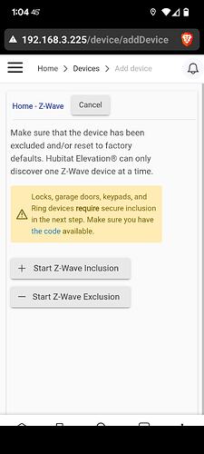

Menu/Devices/+Add Devices/Z-Wave
No Smart Start. Just + Start Z-Wave Inclusion and - Start Exclusion.
Somebody share a screenshot of the app screen with a Smart Start button, please. The phrase Smart Start is not to be found anywhere in my app install. Apparently ZE 800 LR devices require it.

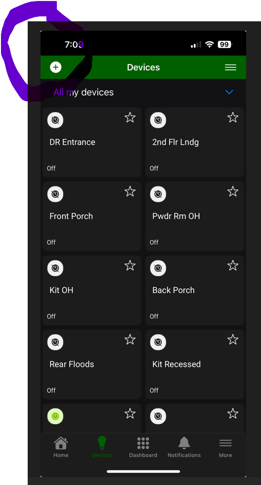

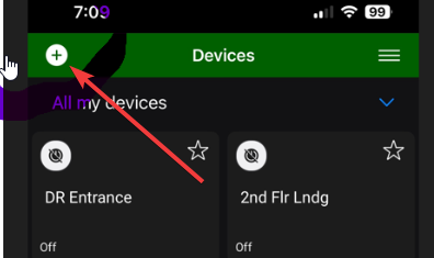

It's the plus sign on the devices tab:
Thanks, @velvetfoot
So far, so good. When you press +, what do you get? Particularly, how do you begin Smart Start? When I press +, I get the screen I posted above. No Smart Start.

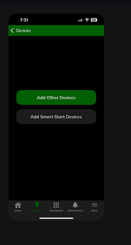

After hitting the plus sign:

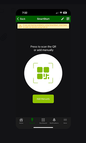

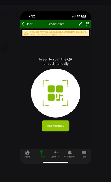

Then this pops up after hitting Add Smart Start Devices:
What you're showing here is not the app - that's just the web page in mobile view. SmartStart requires the app.

Now, if you hit "Add Other Devices", after you hit the plus sign, that also gets you where you are, ie, not where you want to be.

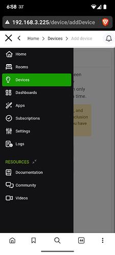

Screenshot: Menu
When I select Devices, the app opens a web page. See +Add Devices button:
Thats the web UI, not the app. Whatever you clicked to get there is not what I showed above. If you click on certain things in the app it opens the web UI within the app.

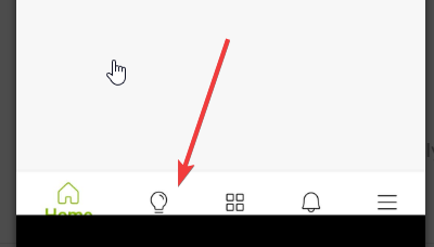

You need to tap on the devices icon, at the bottom of the screen when the app is open, which @jtp10181 and @velvetfoot highlighted in screenshots above:
Until you do that, you won’t find the droids you’re looking for.
