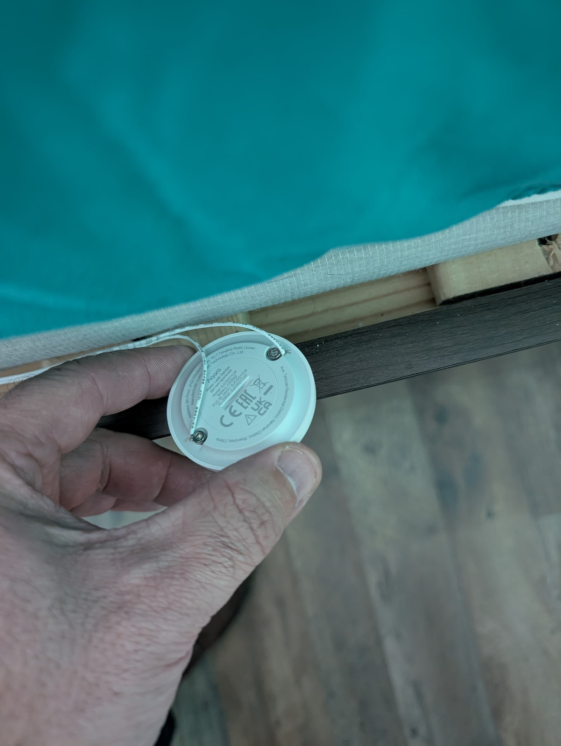

It would be more expensive than the above option but if you don't want to solder wires and such use a pressure mat. I will attach pictures of I use for a different application. Cut the end of the wires off and attach the end of the wires to one screw each on an Aqara water sensor. The mat has two wires the water sensor has two screws. One wire each screw.
Then place it under the cats bed. If cat is in the bed the water sensor shows wet, write the rule to turn the plug on. Then when the cat leaves sensor shows dry and the plug turns off.
I don't know how cost effective it would be for several car beds but would work great for a couch cushion or two.
