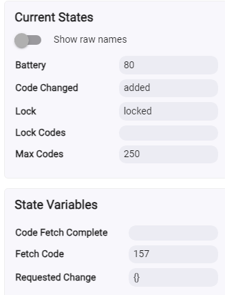

Hi,
Hubitat Version = 2.4.0.148 (C7)
Lock = Yale Assure 2
Device Driver = Generic Z-Wave Lock
I used to be able to see the Lock Codes and position numbers under Current States → Lock Codes, but now that field is blank. The lock codes still work as expected and show up in Lock Code Manager.
Not sure what changed. Any idea why this isn’t working anymore? I need to know the position numbers to make some changes to my code. Appreciate the help, thanks!
Not sure how this will help, but I'm on a C-8, same 2.4.0.148, same driver, and see the codes just fine.
Thanks for checking, I think I figured out the issue. In 'Preferences' of the device, I have "Enable lockCode encryption" turned on. Once I turn it off, I can see the codes.
I'm not sure why the decision was made to completely blank out 'Lock Codes' when that preference is toggled. At the very least, it would be helpful to have some kind of indicator, like 'ENCRYPTED,' to show that the data is still there but hidden.
