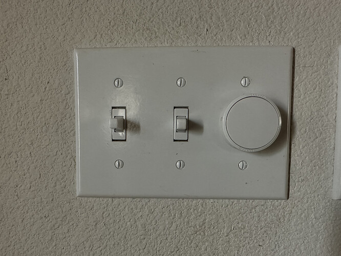

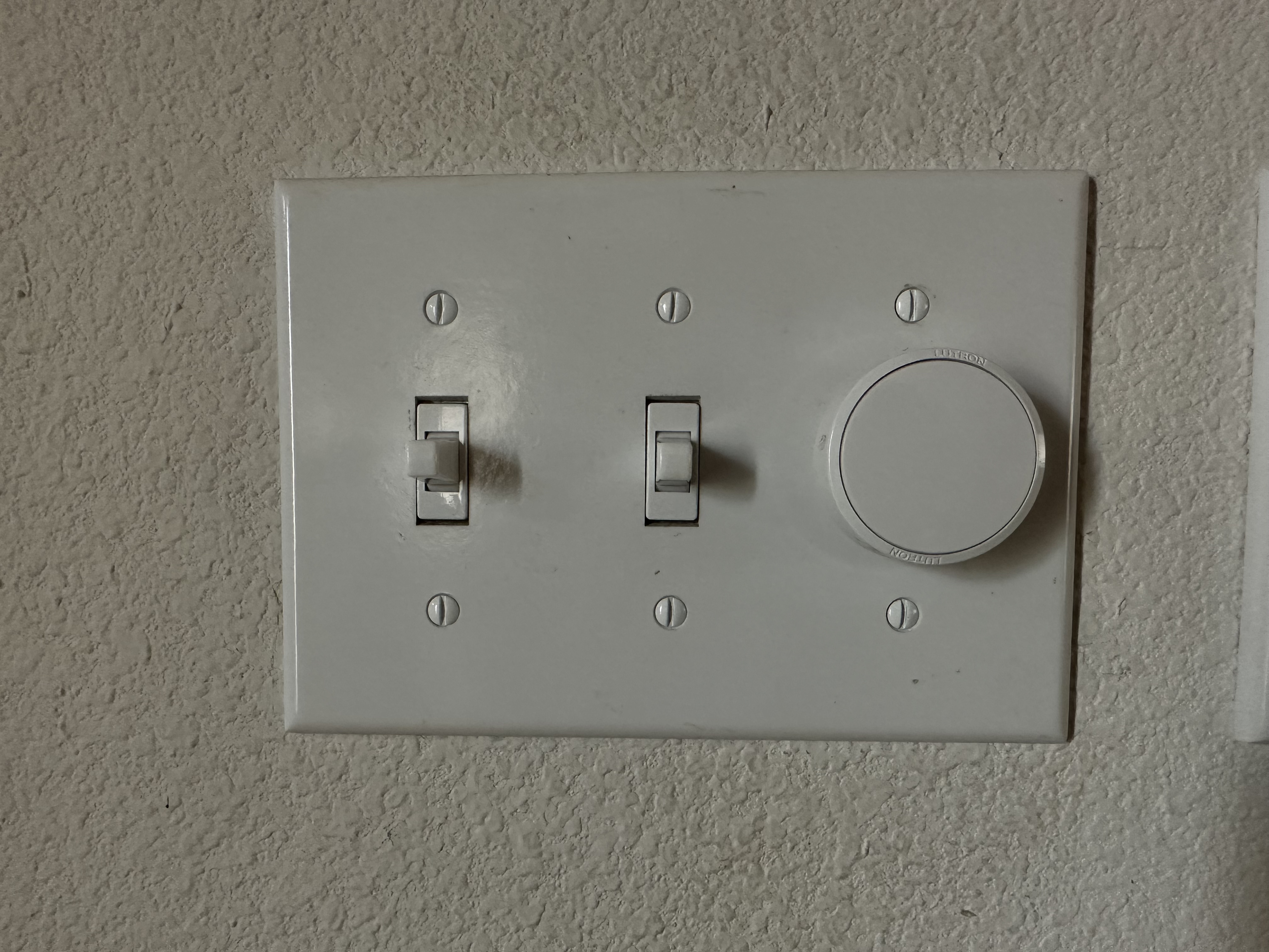

Not an expert here and can't really comment on your questions. But I wonder if you've considered a different solution. I know you said you didn't want a "bandaid" and I get that. But I use these Lutron Aurora Dimmers in several rooms that have Hue bulbs that could be controlled by a switch. They come for use in either toggle-style or paddle-style — the link is to the toggle-style. I'm not sure if they would work paired with the HE hub. I have them paired directly to the Hue bridge and they work great. Push on/off, and twist to dim. Then I use RM rules to change my bulb temperature and level over time. Also, here's a picture of what one looks like on a three-gang box with two smart switches that operate dumb bulbs. They look "normal" and are very guest friendly.

Thanks Jabecker, I did indeed consider them and I actually have a couple we'll say are "in testing" that I'm using for some light strips that don't have a switch, they're just plugged in as accent lights for furniture. I mounted the aurora directly to the piece of furniture. This is definitely a happy medium and doesn't look like duct tape and band aids, a nice elegant solution.
I'm being picky but I'd prefer it didn't even look like a smart home device. I want it to look like a dumb switch and keep the visual evidence of smarts to a minimum. In fact, that's why I haven't explored it before now because the lutron caseta switches don't look and operate like dumb switches. I've also considered the companion Brilliant switches that allow you to enable/disable the relay and haven't pulled that trigger for the same reason - they don't look like a normal switch. So it's a good suggestion and would probably be my second choice. I'm just holding out hope for my first choice I guess.
I'm probably showing my age, here, but the first dimmer switches I ever remember seeing were the rotating type. The aurora's look enough like those that to my eyes they don't scream "smart home" so they work OK for me. But I certainly understand that they are not to everyone's taste.
