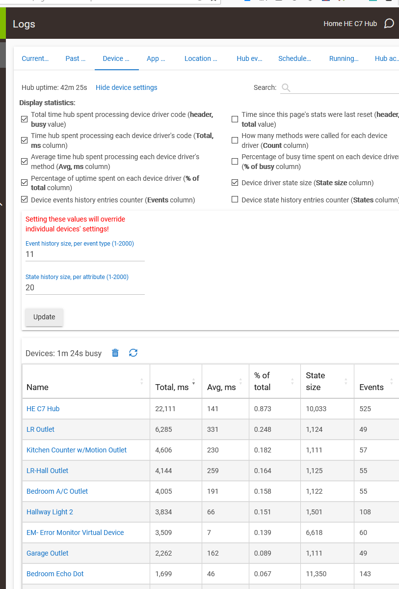

If you go over to App Stats or Device Stats in the logs tab, is there any one device or app that is chewing processing time? I go to the App/Device stats settings and enable all columns to get a better picture of what is going on within stats.
