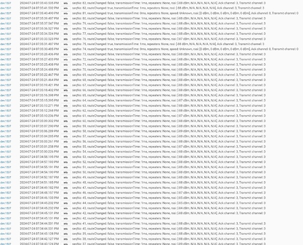

I noticed when running "config all" and "refresh all" on Inovelli 2-1 dimmers that the ZWave logs seemed to come in slow. I'll post a screen shot, but there's at least a full second between each line, sometimes longer.
I'm pretty sure I remember running "config" that the ZWave logs would slide down the page much faster, at least 3 or 4 times this speed.
I'm on C8 Pro, and recently excluded these switches and re-included using the the QR code, confirmed they are on ZW-LR.

Those are both pretty intensive commands (related: is there a reason you're running them in the first place?), and the driver likely inserts a long delay between them to avoid flooding the Z-Wave network.
Also, Z-Wave Logs are generally not very useful for troubleshooting; keep in mind they only show commands sent from the hub. Regular Logs are a better source of general information.
I was running these commands because the firmware version wasn't showing up in the device page. I keep an eye on the Zwave logs when running config/refresh to get an idea of when the commands are done running.
Since excluding 38 devices and reincluding with SS using ZWLR, I have had a few hiccups regarding ZW: Having to send commands more than once, command states not updating after executing. Not rampant but I've noticed it happened a few times in the last few days. I'm hoping these quirks will work themselves out as the ZWLR finds the optimal transmit power to use.
Back to the original post, I don't remember 1 second delays between each line before I switched over to LR. Is anyone else noticing this?
