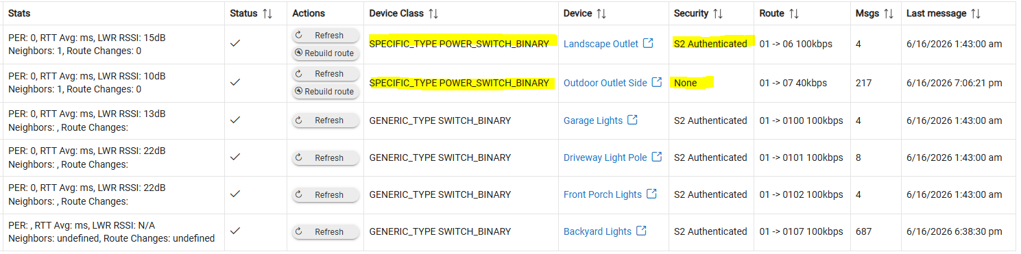

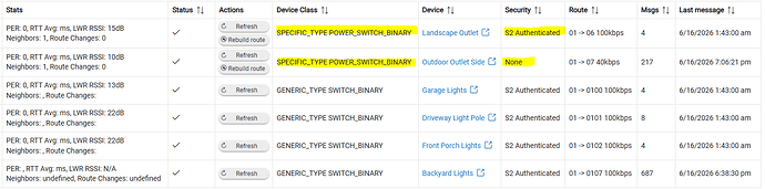

I’m thinking this is the issue then. I have two of these outlets that I purchased from eBay (new) at different points in time. While the plug and model number are the same, the boxes they both came in are a bit different than each other. I’m starting to wonder if one of these outlets is an older version of the model that doesn’t utilize security…
I’ll first set the Zooz switch to have no security just so their levels can at least match for now to test your solution. I’ll report my findings back soon.
I got mixed up on my GE/Enbrighten Z-Wave outlet boxes. Them being different sizes was indeed the tip-off: One advertises S2 security + SmartStart support while the other doesn’t, and I got the two boxes mixed up.

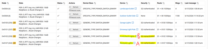

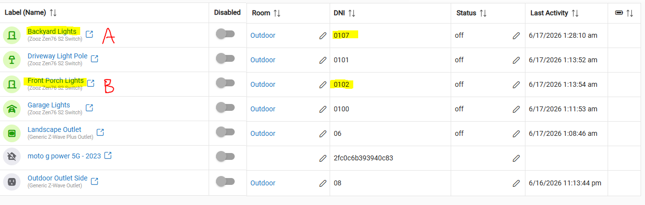

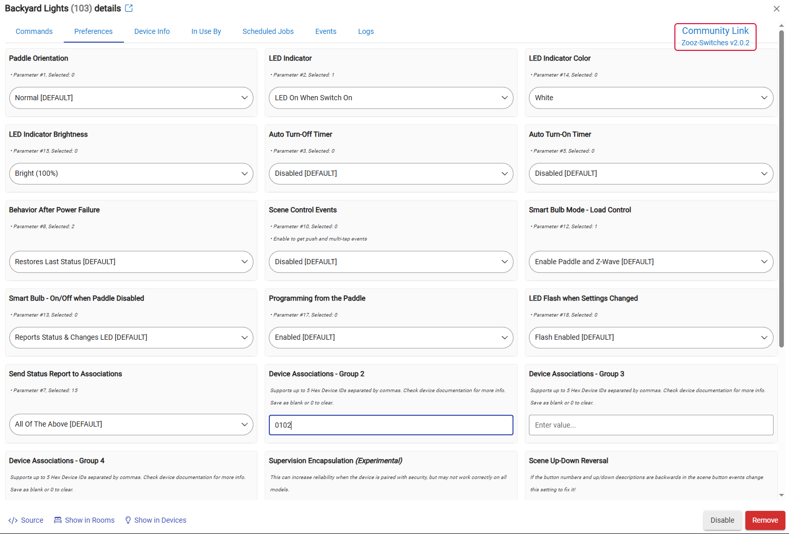

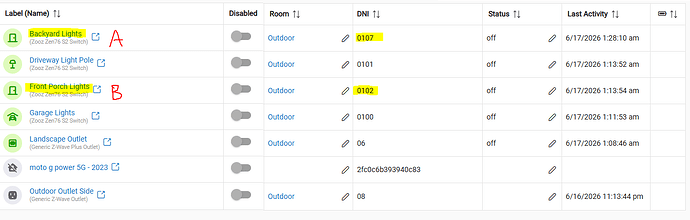

I feel like I’m going crazy. As a test, I’m throwing the GE outlet out of the equation and just testing against two Zooz ZEN76 switches. Both have S2 security, SmartStart enabled, etc.
For our tests, let’s say that when I press Switch A (DNI 0107) I’d also like it to turn on Switch B (DNI 0102).
Here’s what I’ve tried:
APPROACH A:
I installed the Zooz ZEN Switch Advanced driver and assigned it to Switch A (also tested assigning it to Switch B, as well).
Upon assigning, I told Switch A to associate with 0102 (the DNI for Switch B) in Group 2:
In addition to “0102”, I also tried “102”, “66” (the hex value of 102) and “0x66”.
None of this worked. When toggling Switch A it would not associate/toggle Switch B with it.

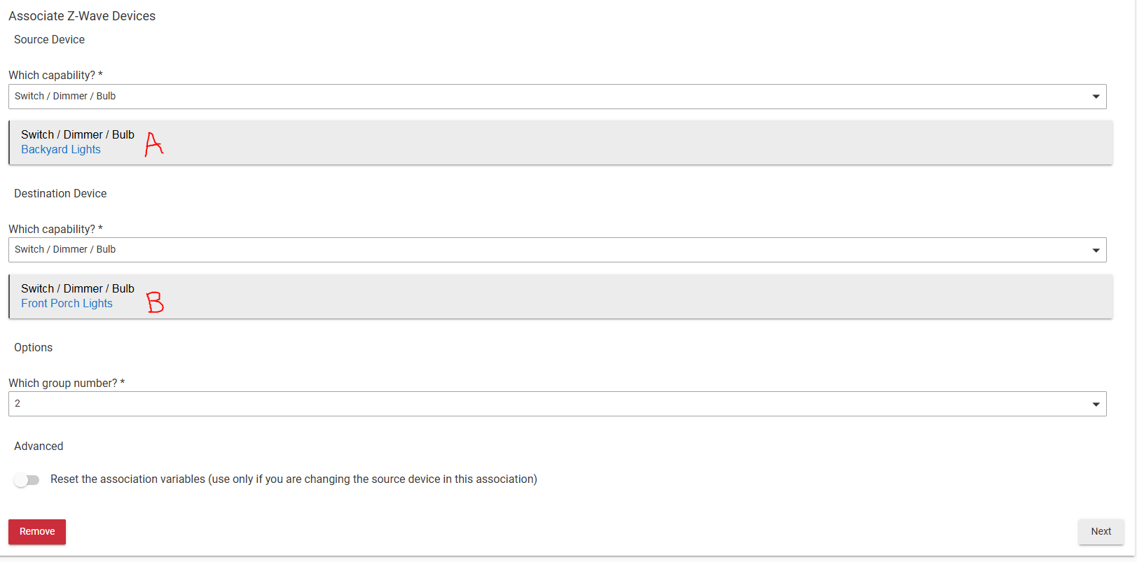

Next up I downloaded the parent Z-Wave Association Tool and its child Z-Wave Association apps.
Before proceeding, I set the drivers for the switches back to their defaults (which is “Zooz Zen76 S2 Switch”, in this case).
Once the apps were installed, I opened the app and told it to have Switch A (source device) associate with Switch B (destination device), using Group 2:
I also tried this using all Groups 1-5 with no luck. As before, when toggling Switch A it would not associate/toggle Switch B with it.

But, do you have LR enabled? Association doesn’t work with LR.
You have to look for the specific manual as far as that parameter goes. It was the one for alternate exclusion method.
It was just a guess though.

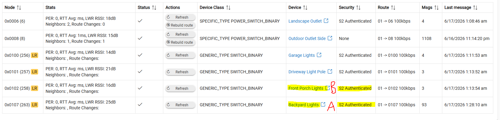

How do I disable it for the devices? The only way I'm aware to do so is through the Hubitat app by going to the SmartStart section.
The switches were indeed set to Long Range and I changed them here, but the changes didn't seem to update on the devices themselves (checked their statuses in Settings > Zwave Details).
To change a ZW device from LR to Mesh (or vice versa) requires excluding that device and re-including it.
Yes smart start defaults to LR if it’s available. For mesh mode I prefer to pair via the device gui and skip smart start.
DA only works with mesh devices, no LR.

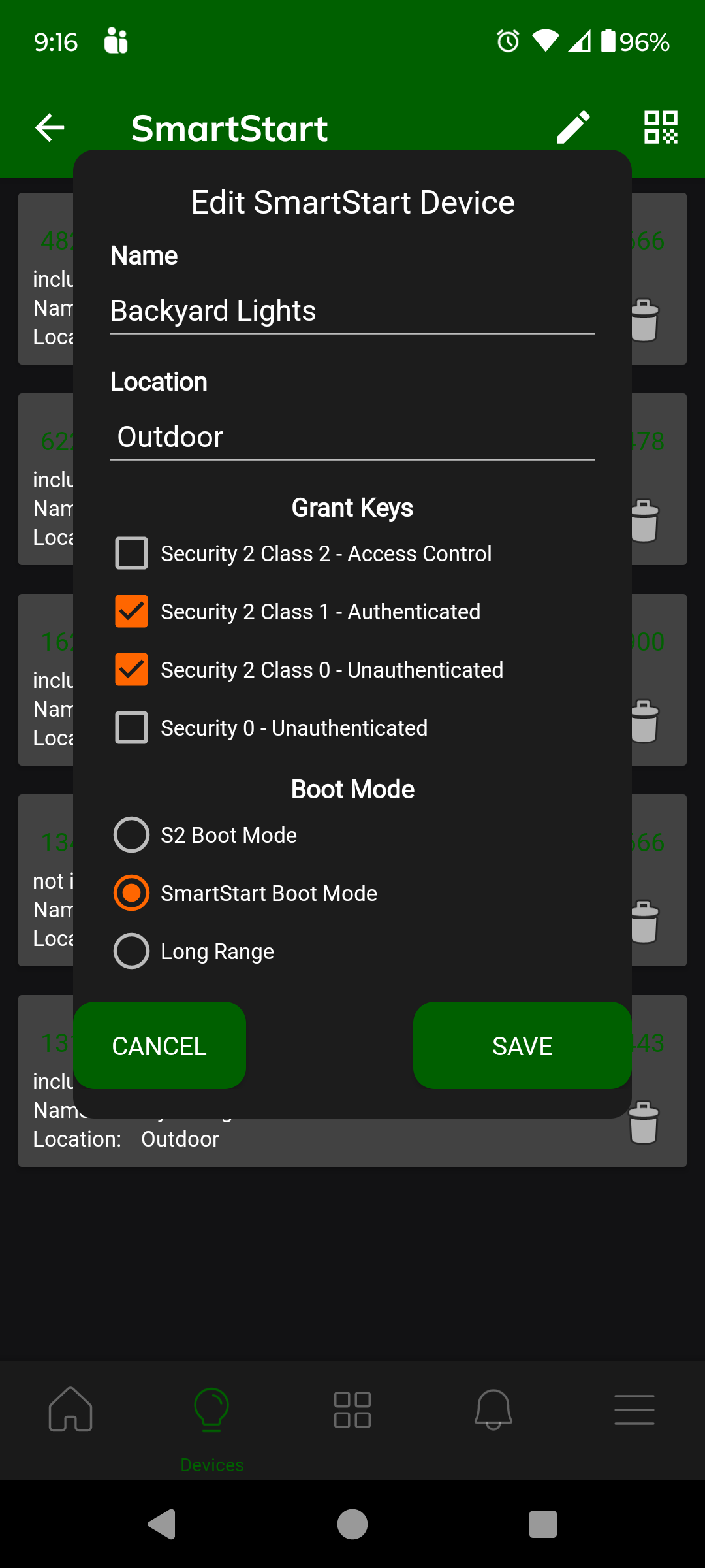

Thanks again, everyone. I’d like to write down the solution to my woes here in case anyone else runs into similar setbacks (also for me to reference in the future in case I forget!).
These steps are to create Direct Associations for Zooz branded on/off switches and GE/enbrighten outlets. Your mileage may vary for other devices.
  1. Ensure your devices are added via SmartStart using the Hubitat app
    1. Ensure no power is going to the devices you want to add. If your hub is on the same electrical circuit as the device you’re wanting to add, you’ll need to temporarily move the hub to a different circuit in order to kill power to the device.
      1. If your device has been added to your hub previously, you will need to fully exclude it from the hub prior to performing the step above.
    2. Scan the device’s SmartStart QR code or manually enter in its DSK.
    3. Upon entering the info in, ensure the following options are set for the device:
      1. Disable Long Range (LR) mode for the device. For my purposes, I set the devices in question to “SmartStart Boot Mode”.
      2. For quicker, more instantaneous/synchronized on/off action between associated devices, you should not use any security levels for the two devices in question. Set its Grant Keys to Security 0 - Unauthenticated.
    4. Restore power to the devices and they should be correctly detected/added into your hub with your customized settings applied as mentioned above.
