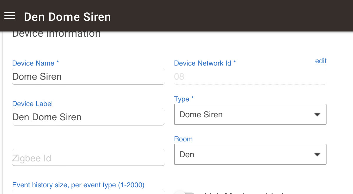

You will find the driver under the device tab, scroll to “Type” like below:
With the Dome Siren, here is how I would set this up in Rule Machine (RM), and would select one of the options from the drop-down in the screenshot (no parameter is required) :
Type: shown
Linear/Vision Siren
Looks like you can select it by choosing “Actuator”. That should allow you to chose one of the available options:
