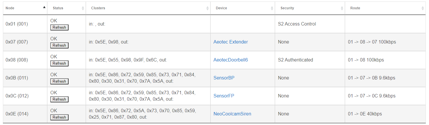

Actually, can this even be accurate?
I have three floor levels in this house. The Aeotec doorbell is on level 3, the hub is on level 1. The extender is on level 2. The extender is shown as hopping upstairs via the doobell and then on to the hub. But sensorBP (back porch) and sensorFP are going via the extender then the main hub with no mention of going through the doorbell, which is supposedly the routing from the extender to the hub

I edited my previous post to show the rather strange routing table

You may have missed my point. The routing table shows that the extender hops via the doorbell to get to the hub. But other devices that hop via the extender do not show the doorbell in their hops.
If the extender goes me->doorbell-> hub
Shouldn't they be going me->extender->doorbell->hub ?
Nope. It isn't linear like that.
Sorry to be a pain but can you explain why the devices using the extender to connect to shouldn't have to follow the same path to the hub that the extender has opened to the hub? The extender has no reason to be going via the doorbell that is much further away and needs to go through more walls and ceilings as well as round a corner.

Because the SOURCE DEVICE decides the route - not the repeater. The repeater just sends the packet on unmodified.
When the message packet gets to the repeater it already has the route information in it. The repeater can't change that. It just sends it where the source device told it to.
I don't know why the repeater chose the doorbell for messages it is sending. :man_shrugging: but that was it's choice. Sometimes a repair will fix it, sometimes not. If the mesages are amking it from the repeater to the hub, it will leave it that way if left to its own devices - if there is no problem in routing, then there is nothing to "fix".
Ok I think I understand that bit now. So the sensors are being sensible lol. The repeater wants a lesson or two
