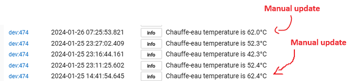

I have a low temp alert if temp is <50°C for 30 minutes. It sometime gets triggered but when I manually refresh the real temp has already recovered >50°C. Looking at the logs it looks like the reporting is set to 10°C changes which may sometime gives nearly 24 hours without temp report.
Would it be possible to add a reporting frequency (temp diff) parameter to the built-in RM3500ZB driver?
