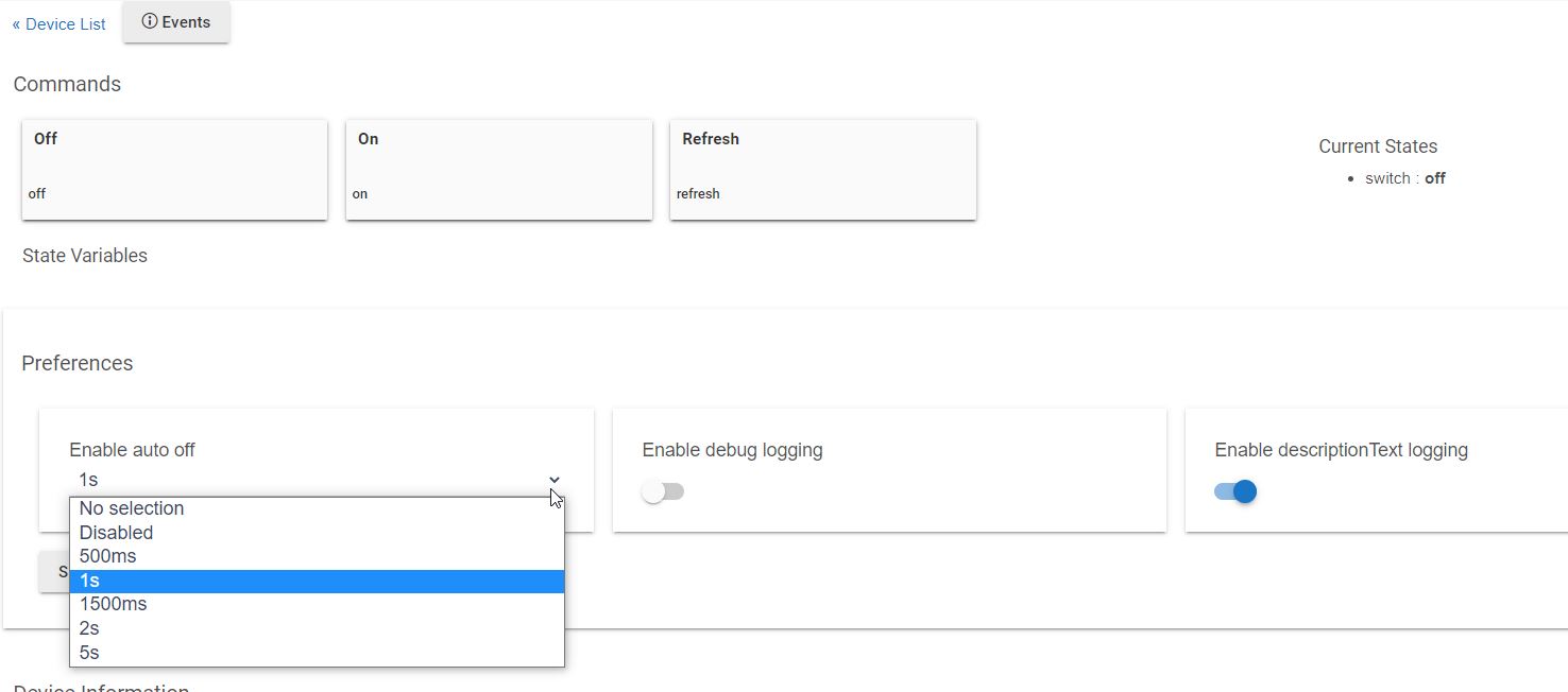

There is the following setting on a virtual switch:
So make a virtual switch and use it to control the door opener.
Or alternatively just add a rule that says when the switch turns on turn it off.
