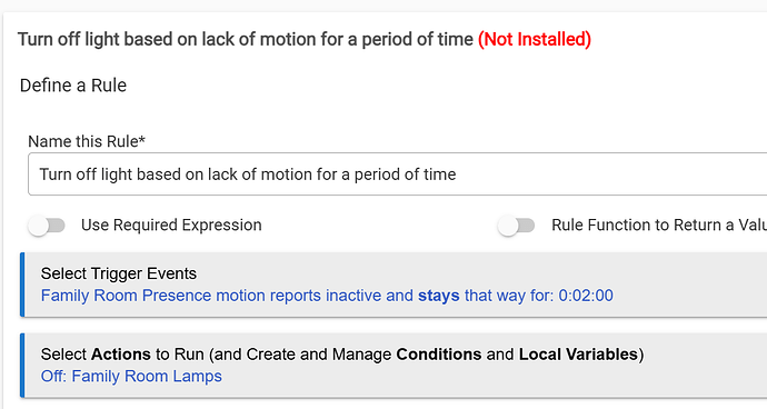

Also, and I hope this is an obvious "yes", what I want the mm Sensor to do is to not turn on a light when presence is detected but if presence is detected to turn off a light once it is not detected for say 1 minute. I'm guessing that in pseudo code it would look like this:
Trigger: Presence detected
Wait: Presence not detected for 1 min
Action: Turn off light X
If so, which app would be best for that?
If you are wondering why I would want such a use case, I have a family member who forgets to turn off lights constantly. So when this 1st person leaves the room (and there is no one left in it) the light will be shutoff. However, I have another family member who often gets up at night and goes into that room. This 2nd person doesn't want the light to come on to make it easier to see going back to bed and to help fall back asleep faster.
Seems like the following would be a very simple solution in Rule Machine.
But don't I need a trigger to have presence detected and then not detected for say 2 min? I'm afraid that with just your 2 commands it would be trying to turn off the light every 2 min.
That’s not how that particular trigger works. It will only start the 2 minute ‘stays’ timer when the motion goes to the INACTIVE state.
No need to worry about motion going ACTIVE as you only want to turn off the light when the sensor goes inactive and stays that way for a specific amount of time.
PERFECT! Thank you!!
