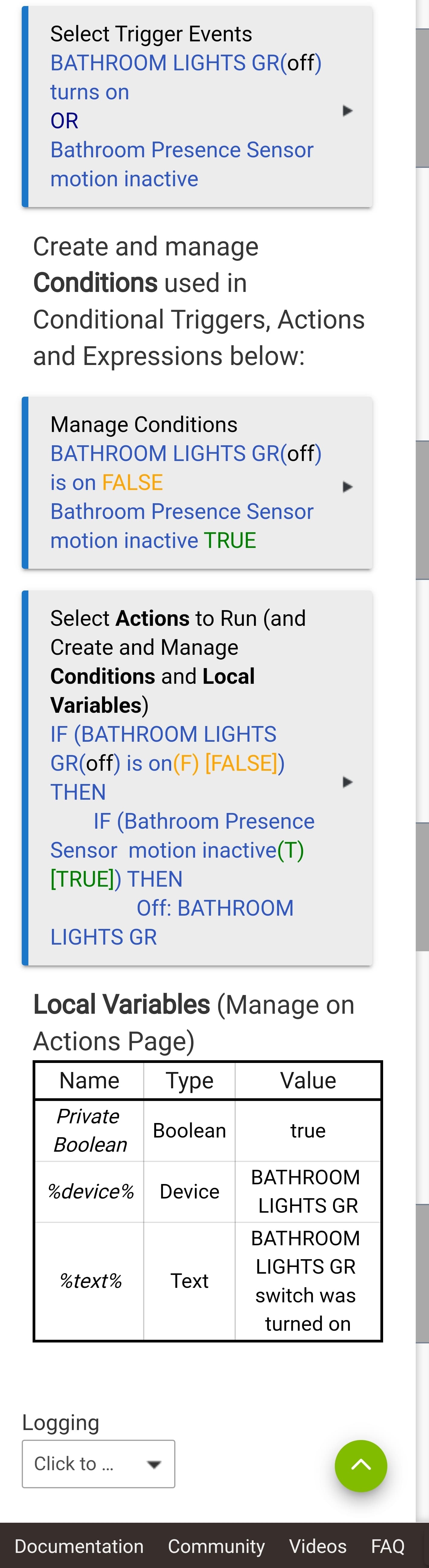

Edit I have tried multiple ways but here is that last I tried
Looking at your rule, I would say either Motion or Room Lighting would be better app than Rule Machine for what you are trying to do. With that said, if you are determined to use Rule Machine, I would suggest the following as a starting point:
Triggers: Motion Active; Motion Inactive (Bathroom Presence Sensor)
Action: If Motion Active, turn on Bathroom Lights; Else, Turn off Bathroom Lights
The above rule will activate your lights anytime it sensor sends an active event and turn off the lights anytime the sensor sends an inactive event. The rule will always activate based on the sensor's event and send an on/off command regardless of the light status.

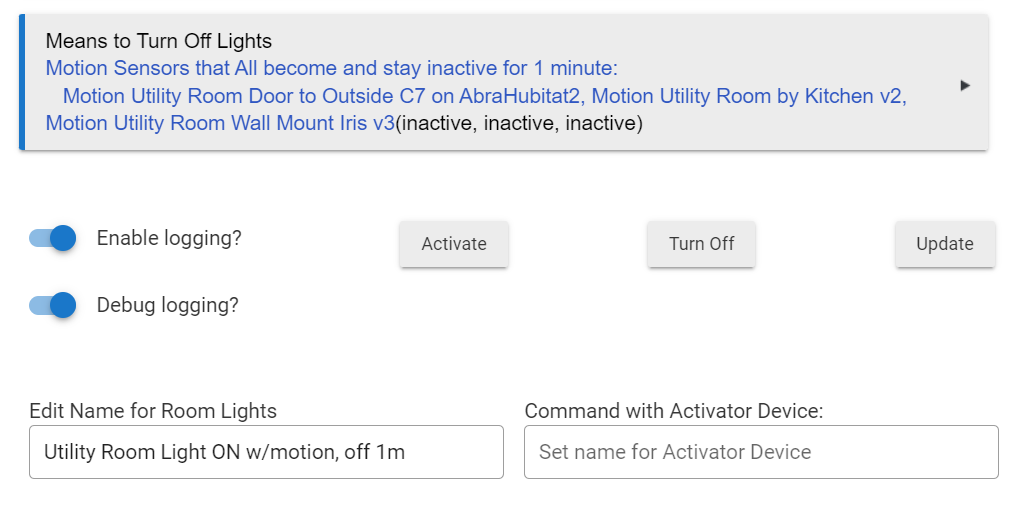

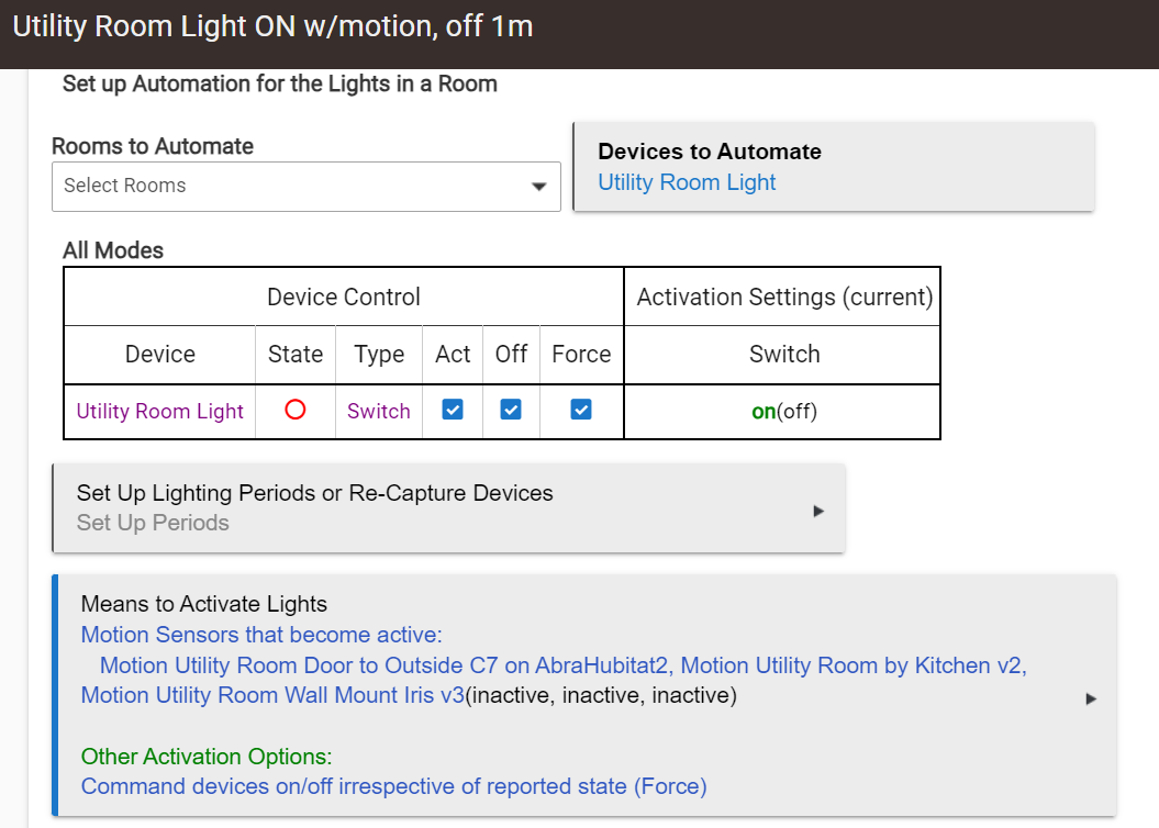

If that's your priority, then using the purpose-built app for lighting automation (Room Lighting) as @bertabcd1234 recommended is your best bet. For example - if you create below in Room Lighting it will just work.
