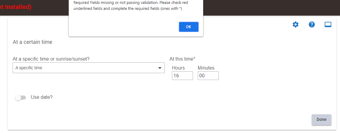

Simple trigger time etc results in "invalid" - no Red line around either
@bravenel It was suggested on the FB group to tag you in this?
I can't get past a simple trigger of 4pm? I've just done the latest update.
Evidently, there is a UI bug with 24 hour clock and this selection. We will get it sorted.
This was introduced in 2.2.8.153. If you roll back to 2.2.8.152 it should work. Or, temporarily change your clock over to 12 hour time, setup the trigger, and then change it back.
Many thanks.
Release 2.2.8.154 is out and fixes this problem.
