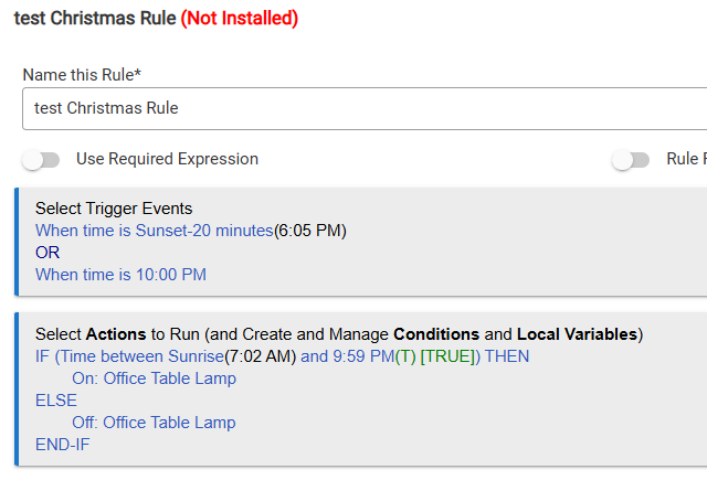

Here is an alternative way without delays and waits. Admittedly a bit busy but if the delays or waits are your problem this gets around that....
it could easily still be an overloaded mesh issue if many commands/rules are scheduled to fire at that specific time
