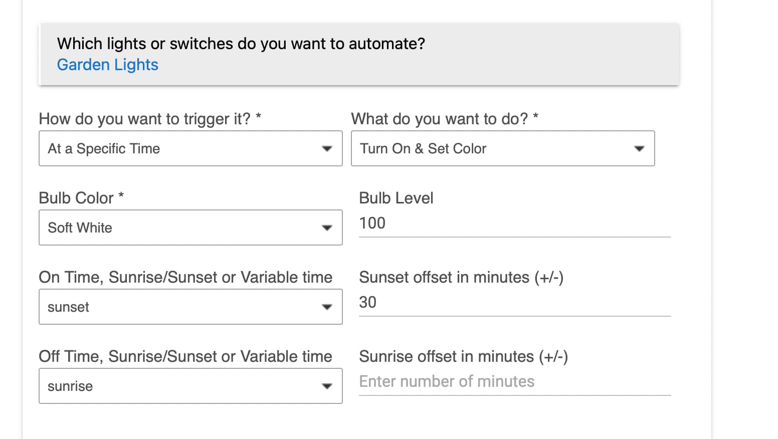

I have a simple rule to turn on a light at sunset and off at sunrise. Sometimes the light remains turned on, despite the status on the device info page being shown at off.
The simple rule is set to have logging enabled, but I don't see any event in the events pane.
I wonder if the rule is not triggering or somehow the command is not being received by the light. I can control it nicely from the devices page.

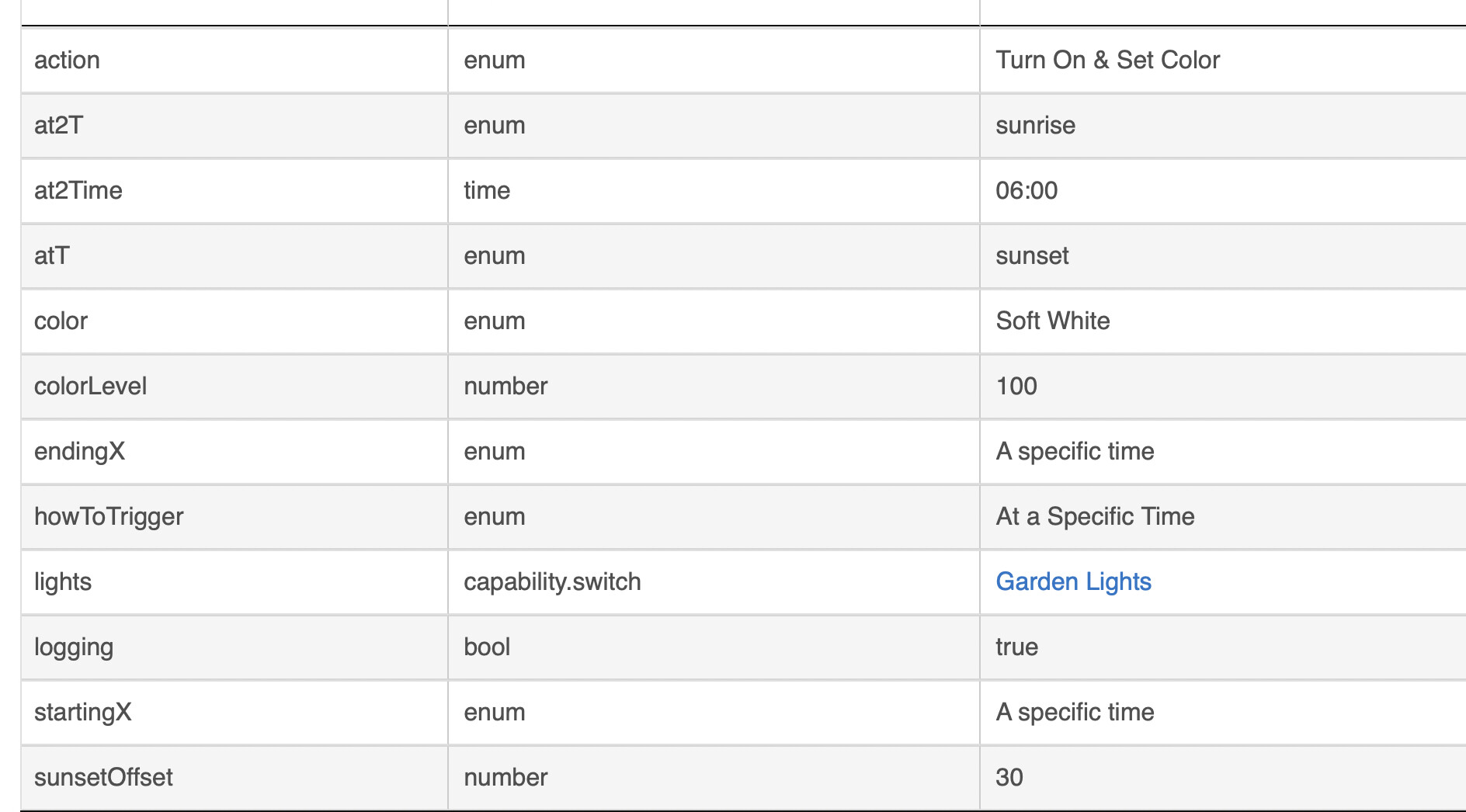

Can you post a screenshot of the rule in question?

From the rule logging I can see it tries to turn it off:
Mar 7 06:30:59 {"name":"Turn On & Set Color Garden Lights at sunset +30","msg":"Turn On & Set Color Garden Lights at sunset +30 anti-Turn On & Set Color","i>
but there's isn't anything logged about the device after that
I just notice that, while the lights are on, the status in the UI is off. Maybe for some reason the status is not tracked correctly and the rule doesn't try to turn off a devices that it's seen as off already
