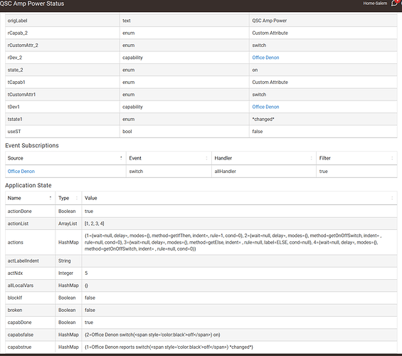

Show the Event Subscriptions from the App Status page (gear icon).
Here you go:
Why are you using Custom Attribute? As opposed to just using the Office Denon as a switch? I'm referring to the trigger definition.
I believe I was having issues with that as well so I thought it needed to be a custom thing. I'll try it again when I get home.

I don't understand why it's not working. My suggestion would be to remove this instance of Rule 5.1, and create a new one. Something's not right, but everything appears right...
And just use a regular switch trigger...
I created a "Simple Automation Rule" using the switch info of the Denon to control the amp switch and that seems to be working fine. Someone might check deeper to see why the rule machine isn't responding to that particular change state, but for now, using the "Simple Automation Rule" seems to be my solution.
