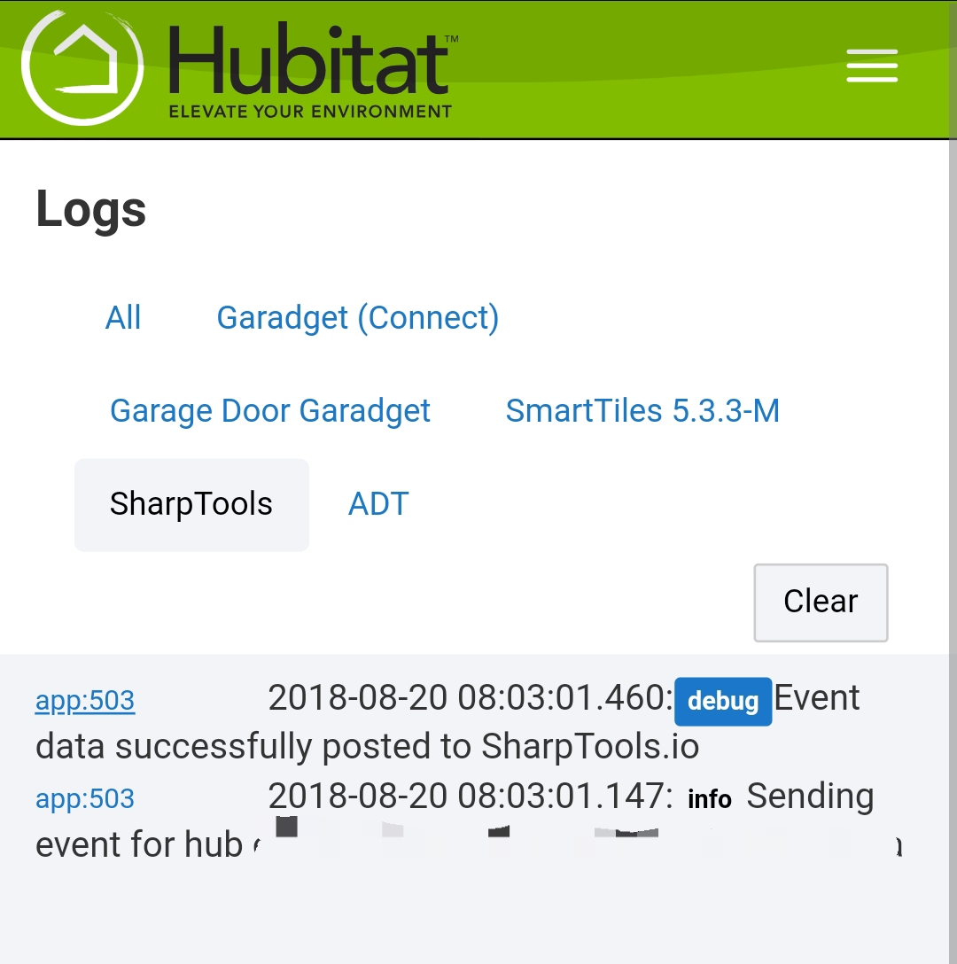

Hopefully quick question here. If I see in my Logs that app: 14 is having issues, what's the best way to determine the friendly name of that app?
You click app: 14 then on the top where you see the name of your devices you will see the device related to app: 14 is darker.
You can also navigate to that app by:
http://HUBIPADDRESS/installedapp/configure/14
I tried that. Normally that works for apps and devices, but in this case (where the log item is an error) nothing shows up. It also has the effect of clearing the log, so I'm looking for another way in.
Thanks.
Thank you @ritchierich . That did the trick.
(Perhaps some day these numbers might be exposed in that app or device list, or even their individual details areas.)
