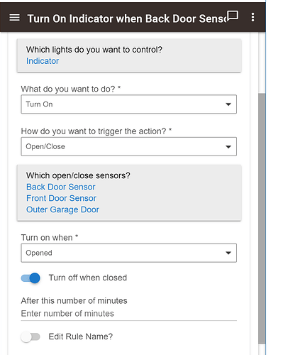

Here is the app setup:
The problem is if 2 contact sensors are open and 1 of them closes it turns off the indicator light.
So the light will be off with one sensor still open.

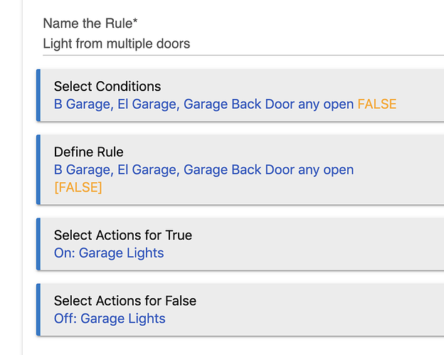

Is there some reason that you can't use Rule Machine for this automation? It allows the selection of "any" or "all" sensors for this sort of automation. Here is what it would look like:
