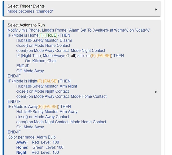

If it was just that one rule, yes. But rules in general on my system run slow. Here is an example from this morning.
I issue a command to Alexa to run my morning routine. Alexa turns on a Virtual switch. HE says that switch came on at 6:15.26. The following rule was triggered at 6:15.27, a 1 second delay which is not bad:
As you can see this rule sets the mode to Home which happened at 6:15.27 which is within a second as it should be. Then there is another rule, shown below, that is triggered by Mode change. It was triggered at 6:15.32 which is 5 seconds later. Why did it take 5 seconds to trigger??
Then among other things this rule closes a contact, Home mode contact. That contact was closed at 6:15.36, another 4 second delay. And HSM was disarmed at 6:15.37, another second.
So it took 10 seconds to do all this??? I have worked with control systems for over 40 years. Even with the crude units we had 40 years ago execution was in milliseconds, not seconds. I can't imagine what is going on in the hub to be taking seconds to see things happen.
This is just one example. As I said, most of the time it really doesn't make any difference as I'm not in any hurry anyway. Don't think this as sour grapes as I like HE. It's just puzzling as to why. And I appreciate your comments and suggestions.
