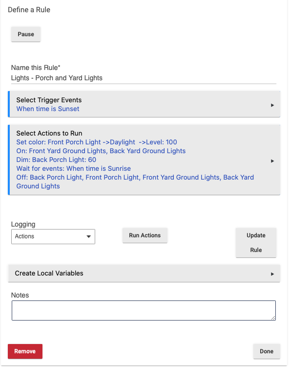

I am not sure how to use Rule 4 or any other version since I hae only used SL. Can someone write or copy how to do this for
Lamp 1 and Lamp2 to turn on at Sunset and off at Sunrise. Thanks for the help.
Here you go...
Thank you for the rule.
Here's another way to do it with just one trigger and the "Wait for events:" action.
