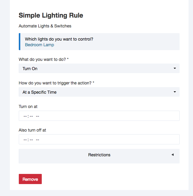

First, I just want to turn on a bulb at "A Specific Time", but when I select that option, my screen refreshes and I see the following screen with no option to enter in a time, or save the rule.

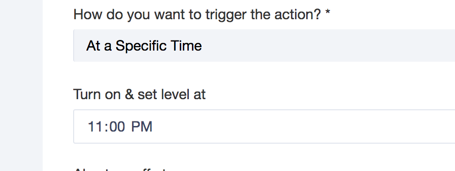

And…just for kicks, I tried the Simple Rule Machine. I tried to set “certain time” for 11:00 PM. When I entered 23:00, the next screen showed me 3:00 AM

What browser are you using? Time inputs are HH:MM:AP --> e.g. 03:00:AM or 11:30:PM, using 12 hour clock with AM and PM, not 24 hour clock. Times in local time zone.
Safari on macOS High Sierra

Sorry I got the upload out of order. The second one shows me setting the time to 11:00:PM and then the first screen immediately follows. This happens either in the Simple Lighting Rule or in Rule Machine
You shouldn’t have a colon between your minutes and “PM”

So I downloaded Firefox 58.0.2 and it worked. What is interesting is that there are a series of dashes and colons in this form:
Oh, wait. I was using Chrome.
Yes, it appears that Safari has some issue with time input. That's very weird.
We will investigate. Sorry for the wrong answer. !!
