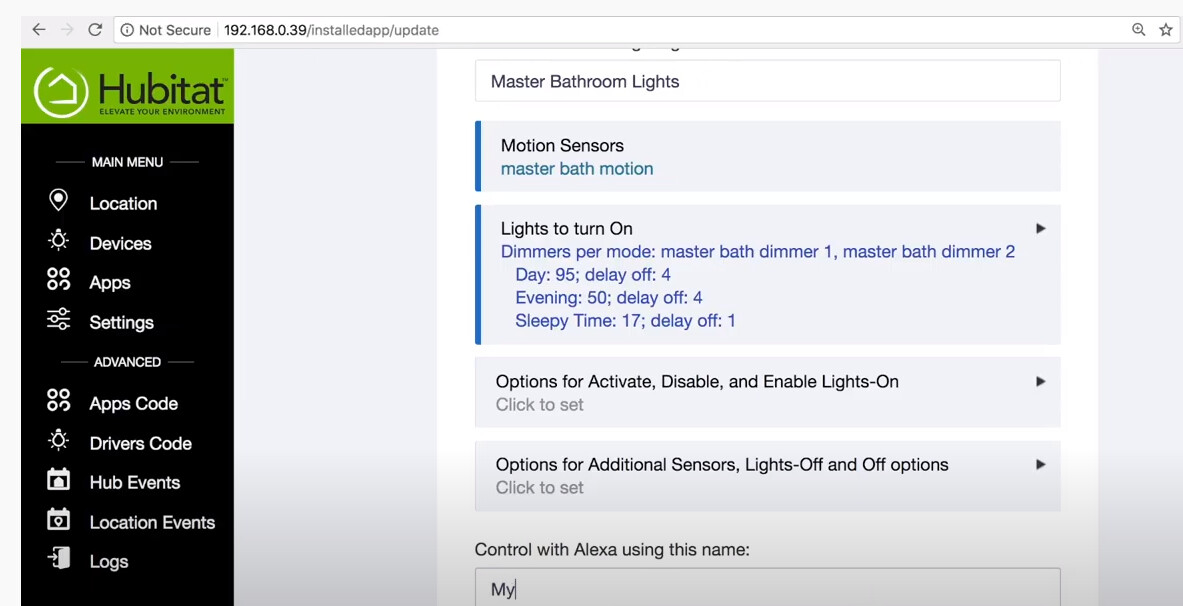

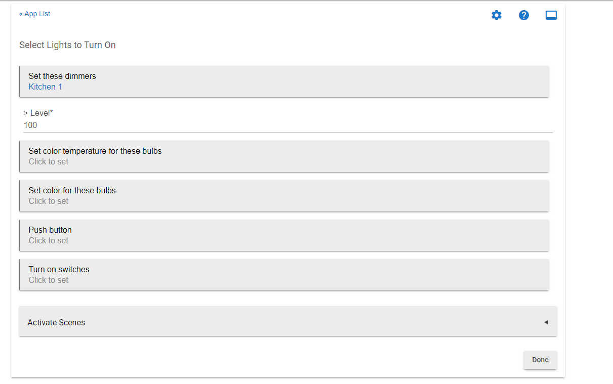

hi mate, I managed to find time today to have a bit of a play around with the ML app but I couldn't find the option to dim per mode? All I get is the dimmer level option, see screen shot.
I even jumped on YouTube and tried following the step-by-step tutorial ( it is 3 year old though) as the guy demonstrates exactly what I want to achieve but again I couldn't find the right option.
I then went on to install the 'Mode Manager app' thinking that the 'dim per mode' option would somehow get enabled on the ML app but it didn't happen.
I feel like I want to give the ML a crack first before trying the RM as I had a quick look at it and sort of struggled a bit with putting the logic together.
I might try the community based ML app you suggested.... unless you can tell me where I can find the dim-per-mode option on the stock ML one...
