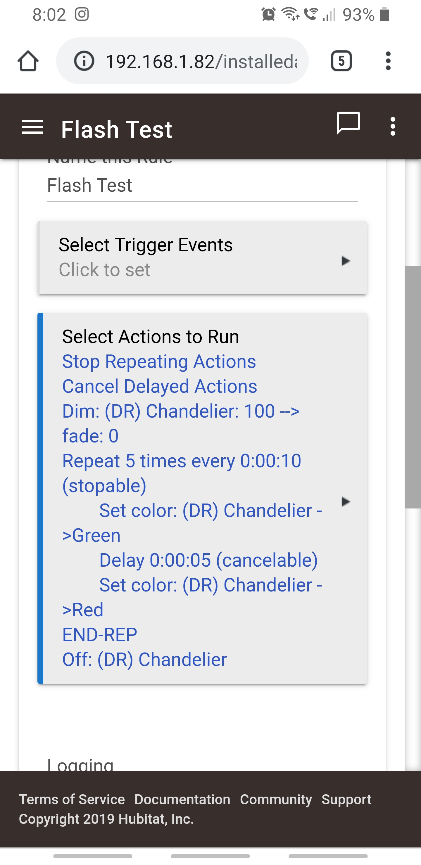

I would brake it down 1st to get things working.
So create a rule and don't even add a trigger, then in the actions do this
So the repeat every is a over reaching delay, you also don't want to be sending more commands than you need so I only send the level once. I have added the cancels so you don't end up creating multiple versions of the rules if you trigger it more than once, but obviously it doesn't stop it as such yet.
You're missing the "END-REP" action. This is required so that it knows, if repeating a block of actions but not all the actions, where to end. Like @BorrisTheCat here is a quick example that works.

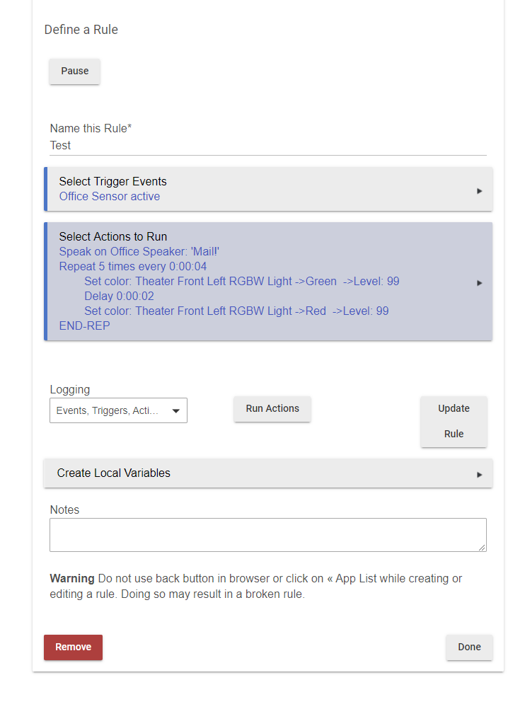

Make sure your "speak" command works on that speaker from the device edit page.

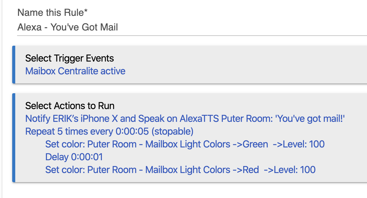

Here is what I did to make a rule that does what you want.
Using a 1 second delay was too short for my bulb to respond so try 2 seconds and see how it goes.
I don't use Alexa so can't really help with that issue but I would gather that the only option would be to speak a notification that it sent it so maybe the speak option doesn't work for these deviec but this is a complete guess.
Yeah, this example by @at9 adds a capture so you can restore it to whatever state it was previous to the blinking.
