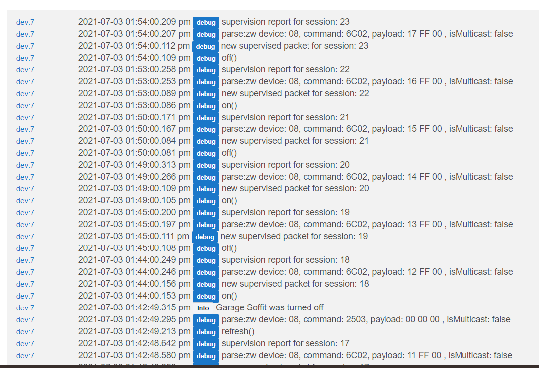

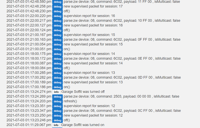

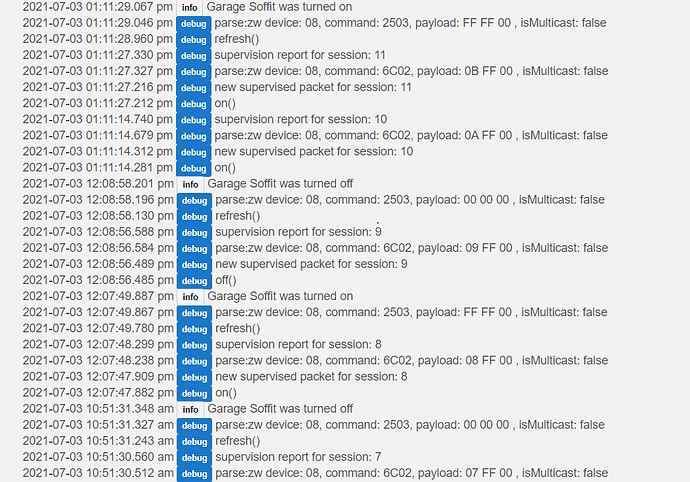

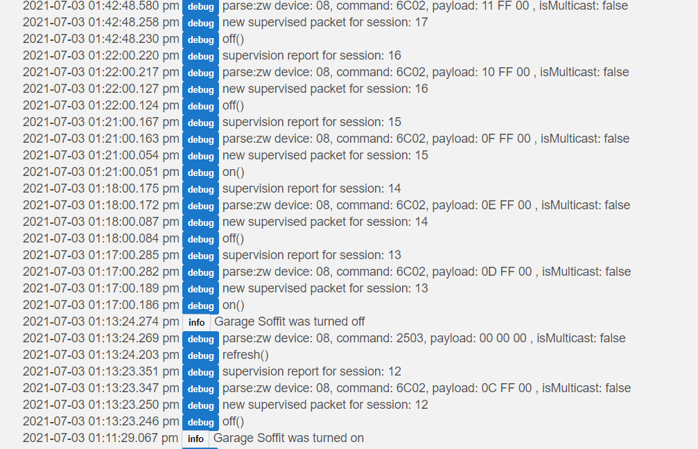

here is the log for the device I am testing if this is of any help. It may as well be Greek to me.

  • The "Logs" page may show you events (if you have "descriptionText logging" turned on for a device, that is generally what that means: event descriptions get logged to this), but a driver could technically do things however it wanted, so it's no guarantee anything actually happened. "Debug logging" will usually show you what's coming into the hub from the device (which the driver may parse into an event), so turning this on and comparing the working vs. apparently non-working devices' messages to the hub, if any (maybe one just isn't sending anything?) may help you--or someone here--see if something looks off.
From what you've said so far, I'd guess that your "Current Sates" aren't updating (because "Events" isn't, either) and the Dashboard is accurately reflecting this--it just happens that both are wrong. So debug logging plus someone familiar with Z-Wave may be the most helpful clues to figure out the difference. In any case, as long as on/off optimization is disabled in Simple Automation Rules, it shouldn't really cause problems in that app: it should send the command regardless of what it thinks the current device state is (so if it works when you do "off" from the device page but not when you think SAR should, there's likely yet another problem; this app has logging you can turn on that may help you figure it out, or you can share the entirety of the app's setup in a screenshot if you want to see if anyone has thoughts on its setup).

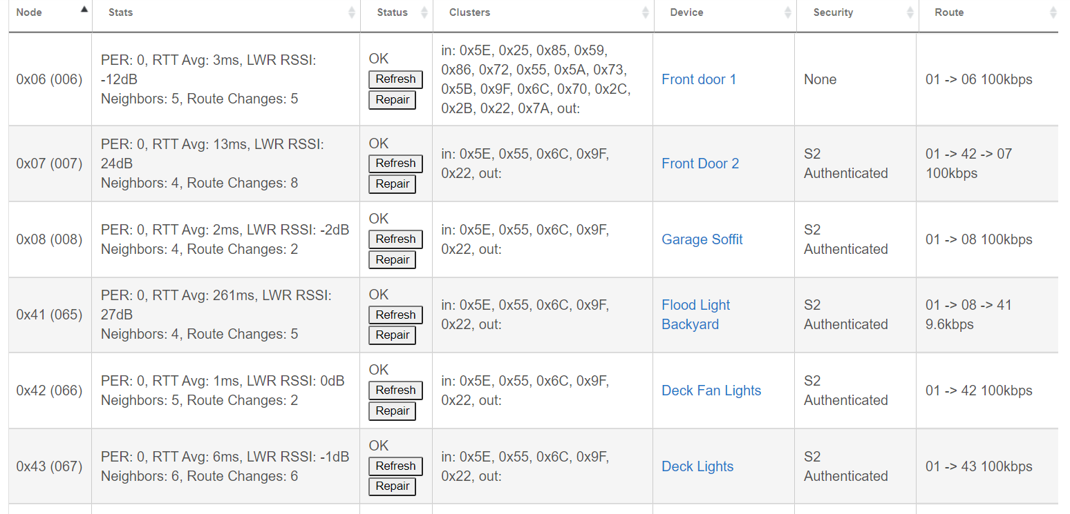

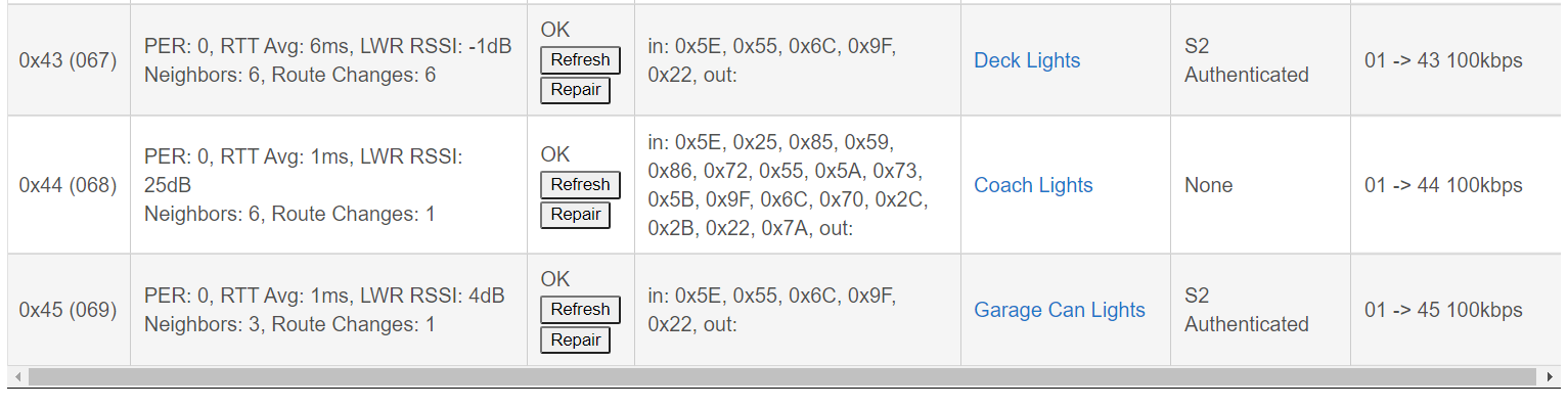

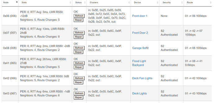

Can you also send a screenshot of your z-wave details page?
I'm wondering if perhaps the issues with inclusion created some ghosts...? These are phantom devices that can sometimes get created when a zwave device fails to include properly. They will show up in your zwave details page kind of like this... no in or out data, sometimes with a "discover" button, sometimes a "remove" button appears above refresh and repair. I suspect that is what @rlithgow1 is thinking as well...
Yeah, a lot of times when things don't want to include it's because of ghosts...It seems to be my go to anymore lol. Invariably we find them, exorcise them, and declare the DB clean... :joy:
And then we rip 'em all out and go Lutron Caseta, but one step at a time!

No ghosts, which is a good thing. A couple of your devices have somewhat weak signals but I doubt if that is it. When you get back we'll no doubt have thought of a few more things to try!
