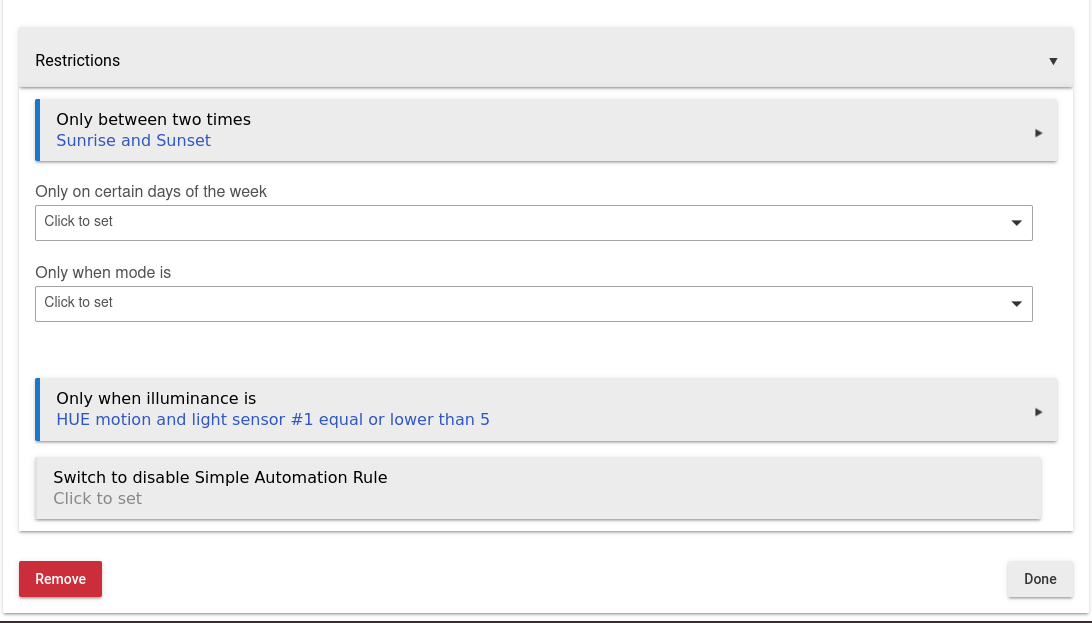

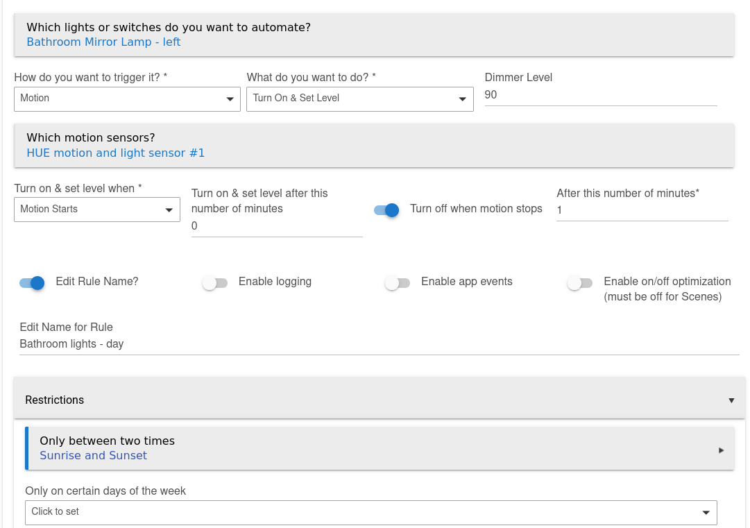

I created my ruled which is expected to:
  • turn the light on between sunrise and sunset immediately if motion is detected, and light is less than 5 lux.
  • turn the light off 1 minute after motion stops
    The problem is that the light is never turning off.

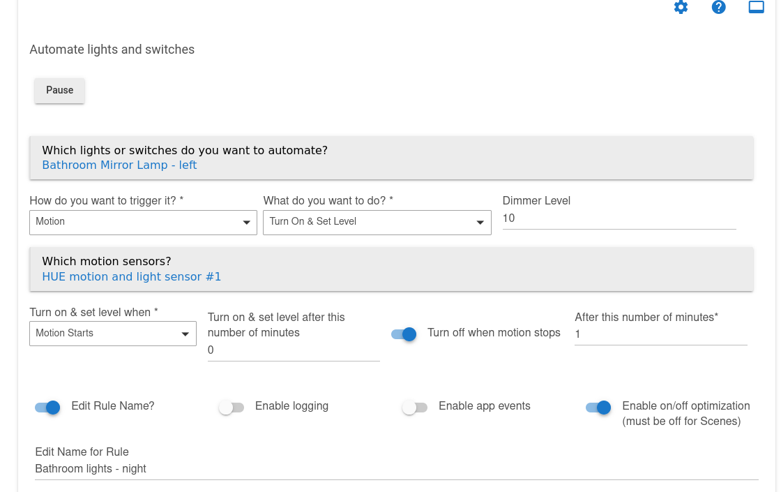

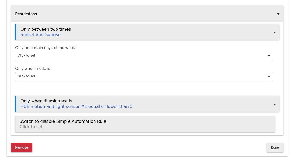

    I've created the very same rule to work between sunset and sunrise setting the light to 10% instead 90, that works (turns on and off) , but this one is not.
    (enable on/off optimization I've playing with but same thing. not turning off)
My question is: "restrictions" only apply for "when to turn on" I assume and not affecting the "turn off" (as its working in my same config for the night)
Any ideas why the light is not turning off?
my other rule (for the night) what's actually working properly:
any help appreciated
hmm. thanks @furom prolly that was the problem. removed the illuminance part and now its turned off.... not sure how can I solve this problem. do you have any ideas?
