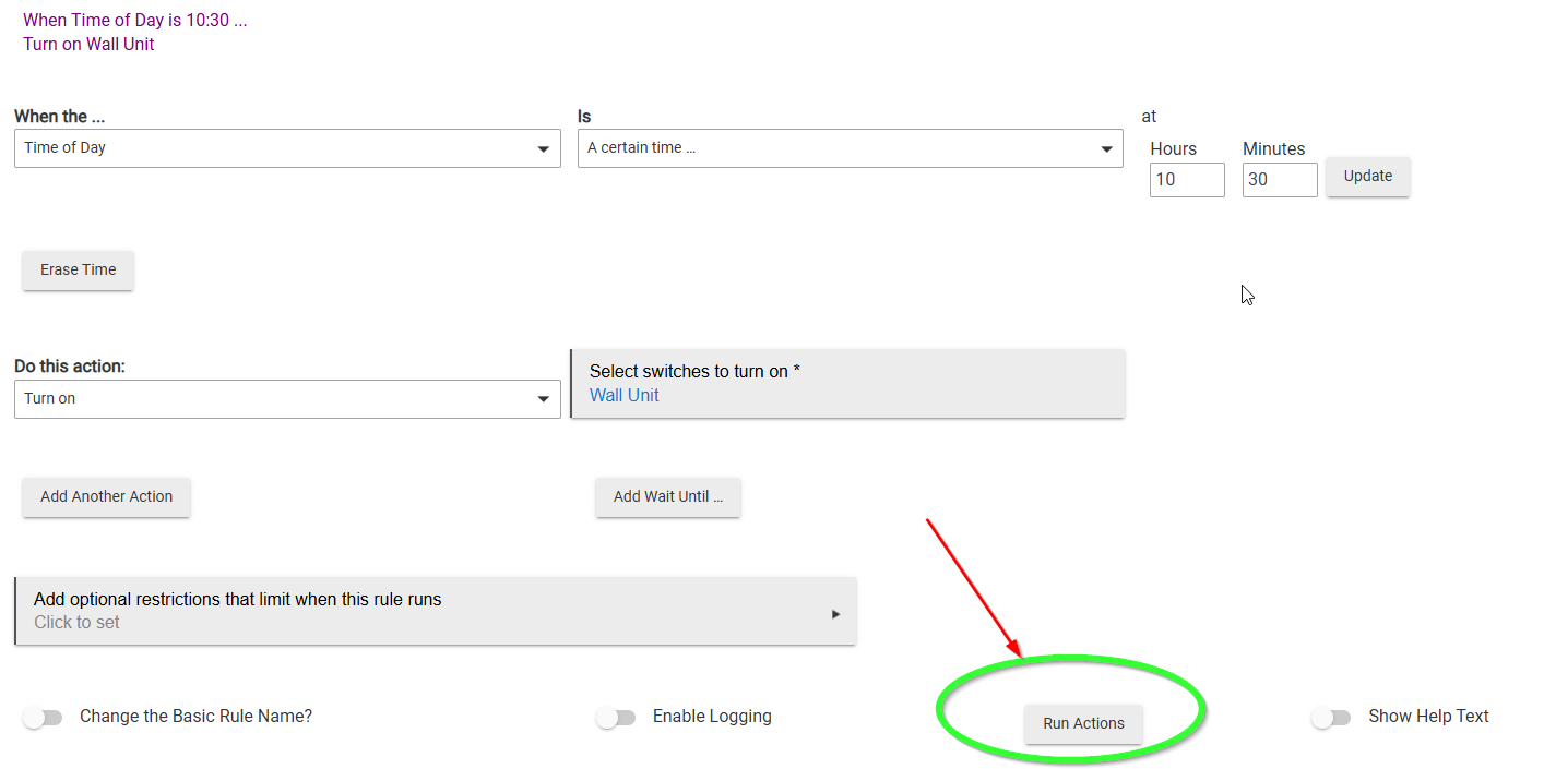

Do your actions take place when you click on the Run Actions button?
Have you checked that the time on the Hub is current and updating?
It's possible that your rules don't seem to be working because you no longer have access to the devices. Can you still control the devices manually from the device page?
I don't see a "Run Actions" button :frowning:

I think the Run Actions button show in the Basic Rules app but not the Simple Automation Rules app...
You are correct. Simple Automation pre-date that feature.

I created a test Basic Rule - simply turning on a bulb at a specific time - and it failed as well :frowning_face:
I did test it with the Run Action button and it worked.
