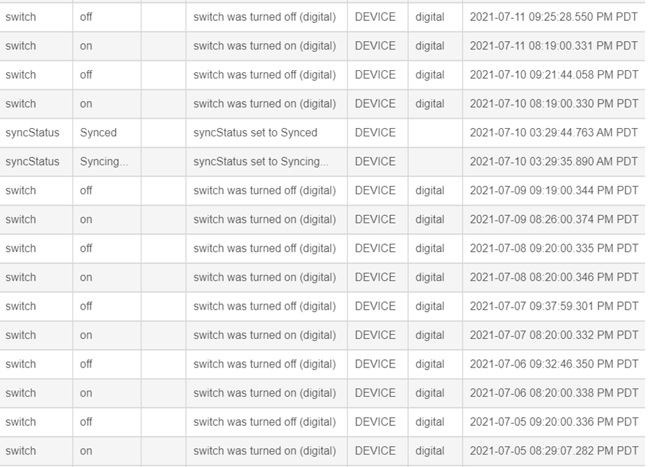

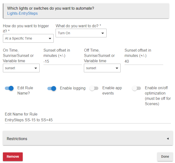

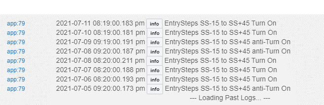

I am trying to debug a Simple Automation Rule that is supposed to turn on a Zen21 switch 15 minutes before sunset and off an hour later at 45 minutes after sunset. The switch turns on correctly but never turns off. The device history shows on and off events according to this rule . However, the Past Log shows the on events but not the off events, which is what actually happens. Does this discrepancy between the two reports indicate a SAR problem, a hardware error, or something else?
Here are partial screen shots of the SAR, the device history, and the Past Log.
PastLog
If the light is turning off when it should, as evidenced by you device events, this is probably a logging bug for SAR. I will look into it.
The light (controlled by a Zen21 switch) does not turn off. It turns on when told to by the SAR but it does not turn off. Only the on commands show up in the Past Log. The on and off events appear in the device history. As a work around I use the switch's automatic turn off option, but it would be good to understand why the Past Log and device event history disagree and why it won't turn off.

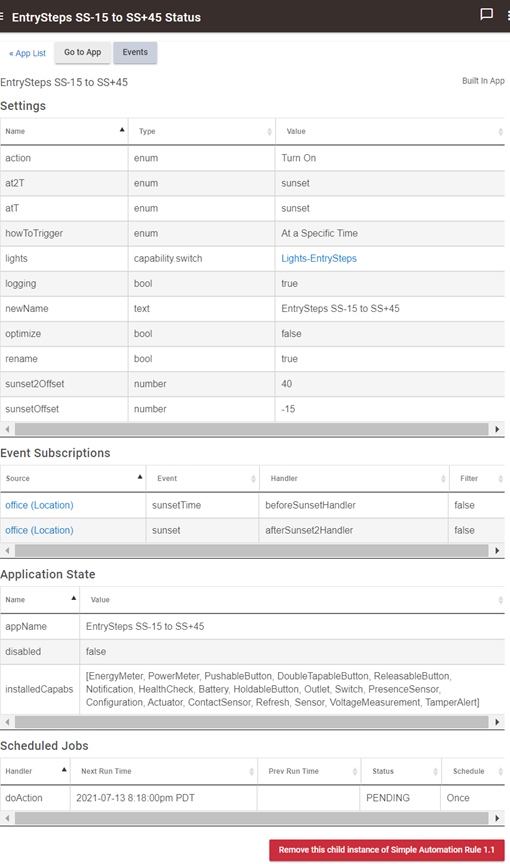

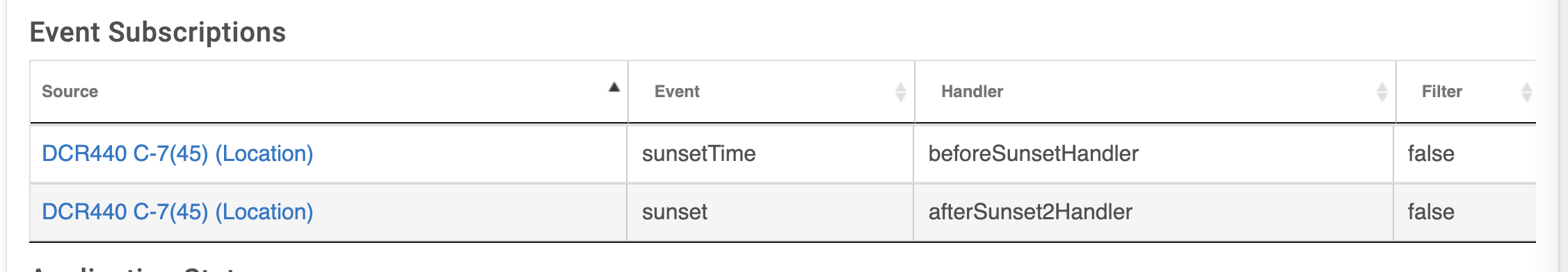

Would you please look at the App Status page for this SAR rule, in the Event Subscriptions sections, and see if it looks similar to this (or better yet, post a screenshot):
Please tell me how to find the event Subscription section and the App Status page.
Cog wheel next to the App on the Apps Listing, or the Cog wheel in the App…

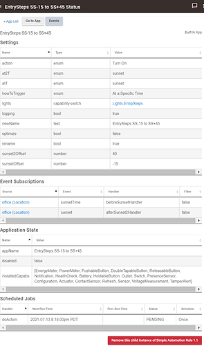

Screen shot taken at few minutes ago.
When is sunset there? Is that right for 15 before sunset, 8:18?
Local Sunset (Sausalito CA) 8:33. Should turn on 15 min earlier at 8:18. It did, in fact turn on then. It should turn off at 40 min after ss, 9:13. Since SAR turn off has not been working, device is set for 1 hour automatic turn off, 9:18 as work around.
Since it is now past sunset, please take another look at the Scheduled Jobs at the bottom of the App Status page, and see if there is one for 9:13. Better yet, take another screenshot like you did a while ago,
Yes, there is a 9:13 scheduled job. I'll watch for it to execute.

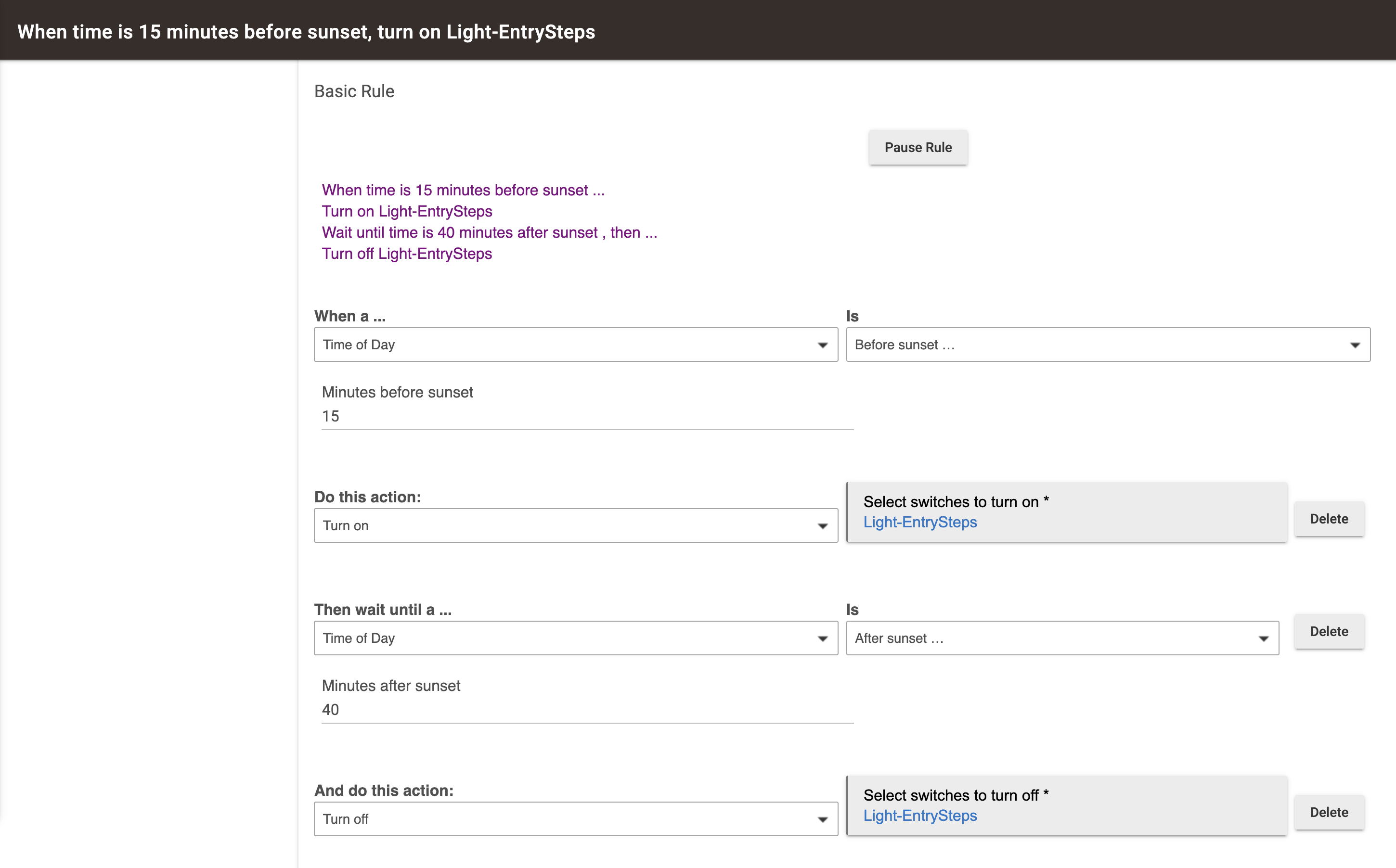

If this SAR rule fails for you, it would most likely be because of this issue where SAR is checking the switch state. If so, use a Basic Rule like this one for this automation:

SAR does always look at switch state. If this is failing for you sometimes, it's because of the device. So you may want to look into that. Basic Rule is not "more reliable", but it does not look at the switch state before it turns it off. So if you have an unreliable device, as the evidence suggests, that's the underlying issue, and Basic Rule will work better for you simply because it doesn't check the switch state (which could be wrong).
