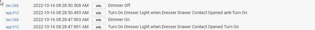

I can turn the light on and off via the dashboard and Alexa and the log looks like it thinks it turns in on and off but nope....

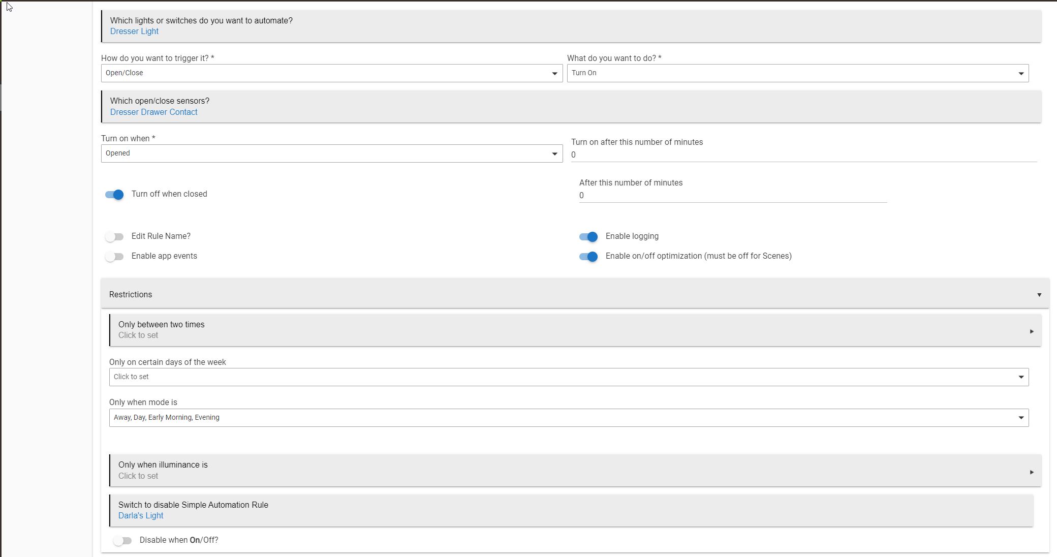

Also I just remade the rule using Simple Automation 1.2 and same outcome.
Figured it out. The "device" it was controlling looks like it's a virtual device that I don't recall creating. It says the driver is Alexa Dimmer. I changed the rule to the real device and now it works. But it was working before so still weird.
