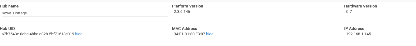

To make it easier to help you, your help request should include a screenshot of the rule in question, as well as the hub sw version (and even hub model).

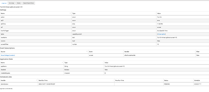

You might click the gear icon while looking at the rule and see what the scheduled jobs are.
If you are wondering what an app is doing, you can always check its settings. From Apps page click on gear icon next to the app. There is a Scheduled jobs section that shows upcoming schedules, but more importantly, if the app uses sunrise/sunset you should see an Event Subscriptions section. In your case, the numerical chage is minor, and it doesn't create a new schedule when you click done. It just saves the new offset number. The app will create the schedule when it receives the sunset event from your location. To validate that the sunset occurred at the expected time go to Logs, then Location Events. If you have any questions about the app Settings, please share a screenshot of the rule in question.

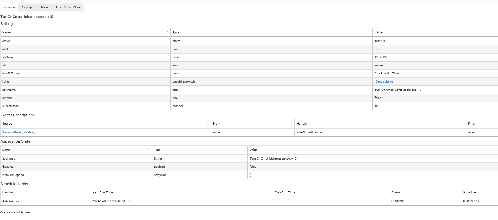

OK, here's some screenshots...
The settings are all OK. Not clear why it wouldn't have run at 10 after sunset, assuming the hub itself was running then. You could look at the Location Events in Logs to see if there was a 'sunset' event today.

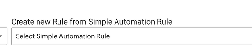

You might move this automation into Rule Machine to get much greater refinement of control and logging. It can be imported directly with almost no effort:
Then turn on all Logging for the rule.
