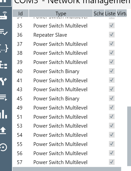

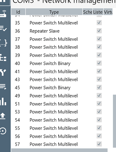

the trick is to click the button named Update. It contacts the Primary and gets a new copy of the DB.. watch the status messages, you'll see that it added new.
Screen Shot 2021-08-07 at 8.18.18 PM
Screen Shot 2021-08-07 at 8.19.00 PM
I already tried that. And got the same status message. But nothing new was added to the list here

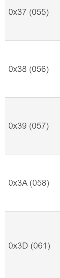

You can see in Hubitat I have two addtional nodes 58 and 61 that are not added to PC Controller
