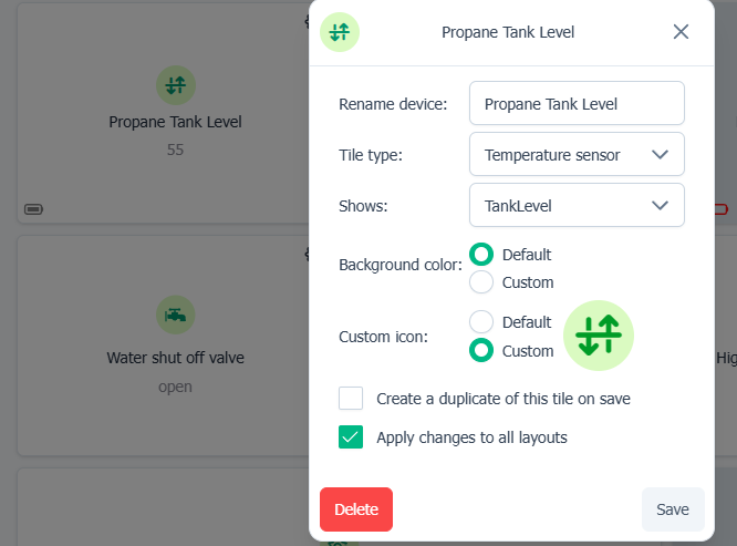

I have the Sinope tank level monitor. Im trying to create an information tile with thr device but it just shows the temp. I dont care about the temp, i care about the tank level. How can i show the tank level?
Classic dashboard or EZ dashboard?
Classic dashboard you can use the "attribute" tile, and just select tank level.
With the EZ dash, It shows funny, you have to select Temperature Sensor as the tile type, and then pick TankLevel. You can see the level and battery in the background on the upper left.

I'm using EZ Dashboards at the moment, I don't particularly like them, but it is what it is.
Thank for the solution!
