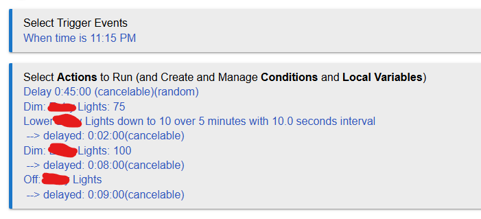

This rule sets a dimmer to 75% at a random time between 11:15pm and 12:00am, waits 2 minutes and then dims it down to 10% over a 5 minute period in 10 second intervals. Once it hits 10%, it waits 1 minute and sets it back to 100%, waits another minute and then turns the dimmer off.
What was the purpose coming back on and then off ?
The dimmer turns back on at whatever the last dimmed percentage was. I want it to come back on to 100% the next time I turn it on. So I set it back to 100% before turning it off. Keep in mind that the rule dims down to 10% only. If I don't turn the dimmer back up to 100% before turning it off, the next time it comes on it would be at 10%.
I assume that dimming devices cannot use "level pre-staging" or the presetLevel() command to set level without turning on.
To be honest, I haven't tried nor could I tell you. I just based the rule off how I know my dimmers work.
If that capability is available you’ll find it listed on the device “commands” page.
Looks like this particulat dimmer doesn't support it.
I'm using a GE In-Wall Paddle Dimmer, 300S with the Generic Z-Wave Dimmer driver.
I just learned something new from AI.
I can exploit the 0-second fade/duration trick to instantly change the internal memory of the dimmer to 100% right as I turn it off, preventing it from actually fully turning on at 100%.
I changed the action in my rule to Dim: E---- Lights: 100 --> fade: 0
Because the fade/duration is 0, the dimmer updates its internal "last dim level" state to 100% virtually simultaneously with receiving the "off" command, ensuring it's ready for full brightness next time.
