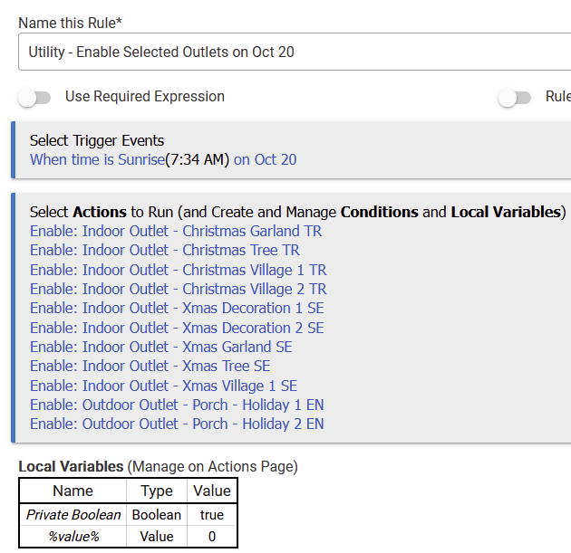

I have an ENABLE rule and a DISABLE rule for my holiday outlets, so that the devices get omitted from many reports for most of the year.
I was not sure if they contributed very much to my HE overhead, even though I don't do anything with them at all until Christmas time. It sounds like I can just leave them alone. Thanks.
