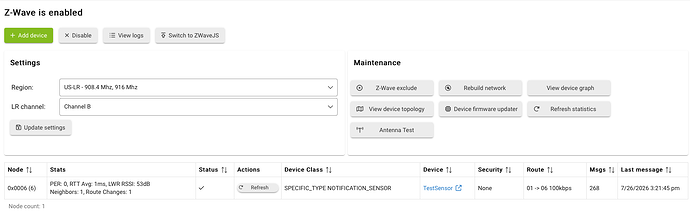

Can you paste a screen snip of your Z-wave details in settings? May shed some light.
I also paired form the web interface and not the mobile app.
Looks good, maybe try Generic Z-Wave Contact Sensor driver instead.
