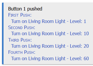

As a workaround you could create a virtual dimmer and slave the shelly to it with Built in mirror app or community switch bindings. I use the latter to control a shelly dimmer from a zwave wall switch. It's not 100% but it works pretty good considering it's switch-> zwave-> hub -> wifi -> shelly. Then you could control the virtual dimmer with your button device. (I also have a zen34 remote that controls the wall switch using Dimmer Button Controller which then relies on the switch binding to control the shelly.) So...assuming the virtual dimmer supports those level change commands, it should work. As an alternative, see if Dimmer Button Controller could work for you straight to the shelly...it's not perfect dimming but I do stuff like this:
