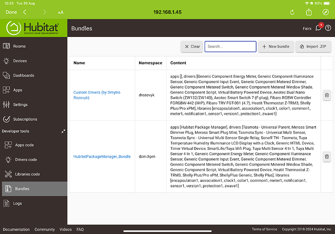

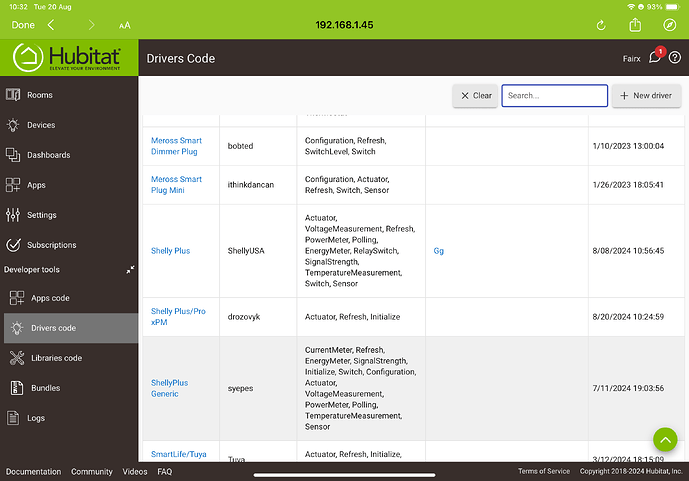

I have reinstalled this version
![IMG_0304|689x481](upload://a7g62kBPAH0OMtaAiL5bKur4BYf.jpeg
System
Drivers now showing
Here is the link (just in case) ge4d / hubitat-code / Bundles / Bundle1.zip — Bitbucket
[downloading and installing bundle again just updates it; you will not get one more bundle but anupdate of all included content; no need to reinstall devices - they will get automatically updated]
