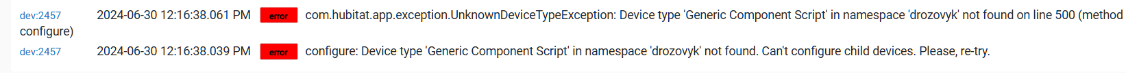

Oh..
It basically says that an event from script instance is nowhere to forward to
Just run "Configure" to spawn child device.
"Unconfigured (1) script instance event" - script from slot 1 sent an event. But there is no child script device to accept this event.
Device type 'Generic Component Script' in namespace 'drozovyk' not found on line 500 (method updated)
This one means it can't find the driver for the child device to install. Did you installed the whole bundle, or file separately?

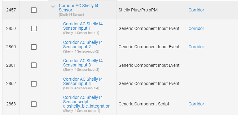

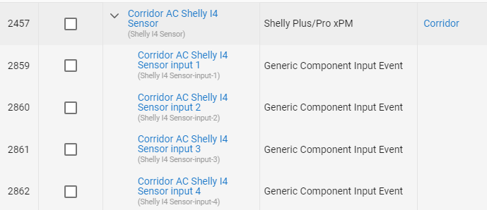

All 4 child devices are present:
Clicking on Configure generates these errors:
No I did not install the entire bundle because I am using only Shelly I4 sensor device. I really don't want to install things which will not be used.

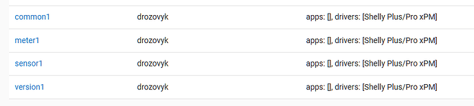

I guess, I installed all required libraries:
And only Shelly driver:
Did I miss something?
Yes. Due to scipt it wants to install "Script child device"
This one

Assuming it worked fine before, you have installed "Input event device" for inputs
ge4d / hubitat-code / Drivers / Virtual / drozovyk.GenericComponentInputEvent.groovy — Bitbucket
Script child device accepts script events so you can handle them from RM
In your case two child devices are needed.
One to handle input channels and one to handle scripts.

yes, this was installed and just in case I refreshed it with a latest version.
I am not sure what for I may need that script child device but now everything looks OK.

Btw, forgot to mention:
You can rename child devices (both name and label) at your taste. Child devices are identified by internal "network id" that is composed from root device network id and child device suffix. Name and label are not used for addressing internally.

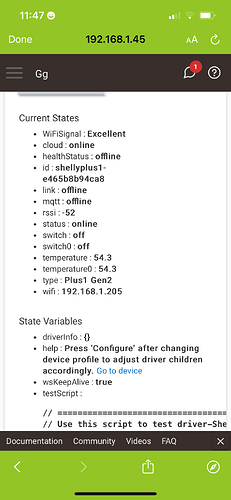

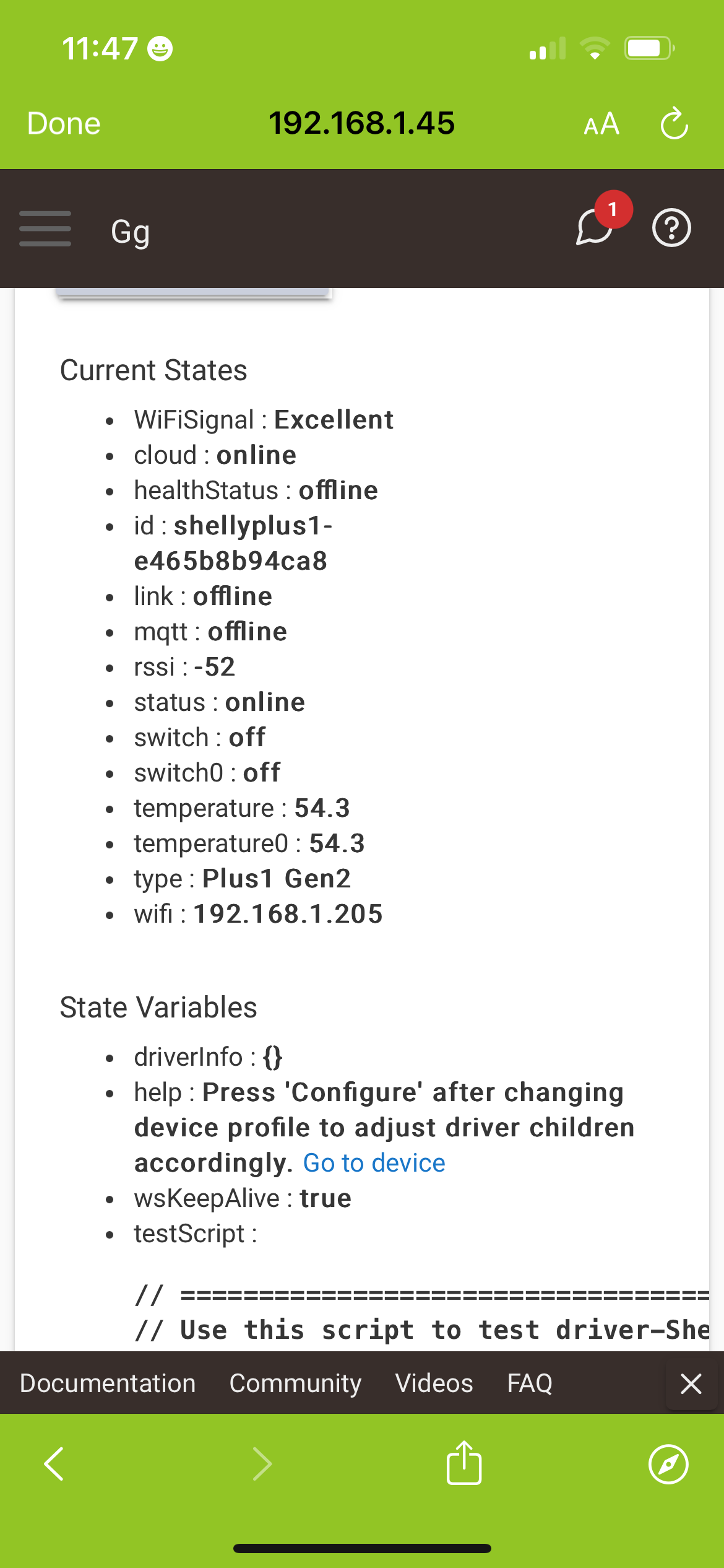

I am struggling with a Shelly Plus 1 with the add on for temperature sensors. I seem to be able to get the basic switch function working but I am unable to get the two temperature probes to register. They are all working successfully on the Shelly app. I have tried several drivers but do not see any child devices after trying configure.
The temperature showing is wrong and hasn’t changed for several weeks
Could you show logs and the bottom part of the driver page with data attributes? There should be a component list to check what driver has received from your device.
Logs might contain some errors. Debug logs are preferable to trace entire data path in case something is messing.

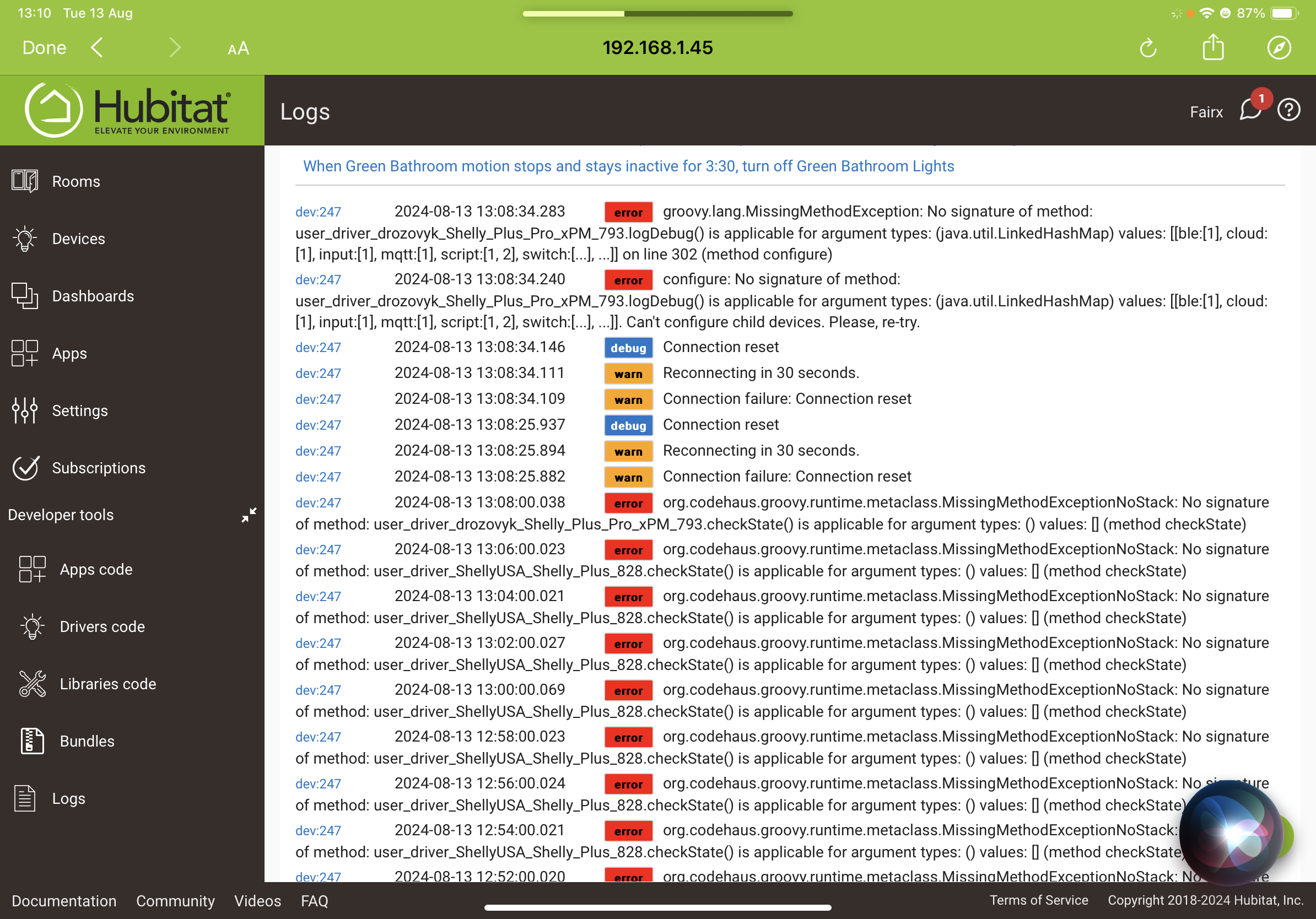

I have changed to the Shelly Plus/Pro xPM driver loaded using the bundle.
Here are the logs I collected
Is it the latest version?
I know this issue. It should be fixed. It is related to the incorrect type casting.
The fix were to use explicit .toString() function of the map that goes into logDebug(..) call.
