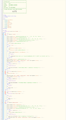

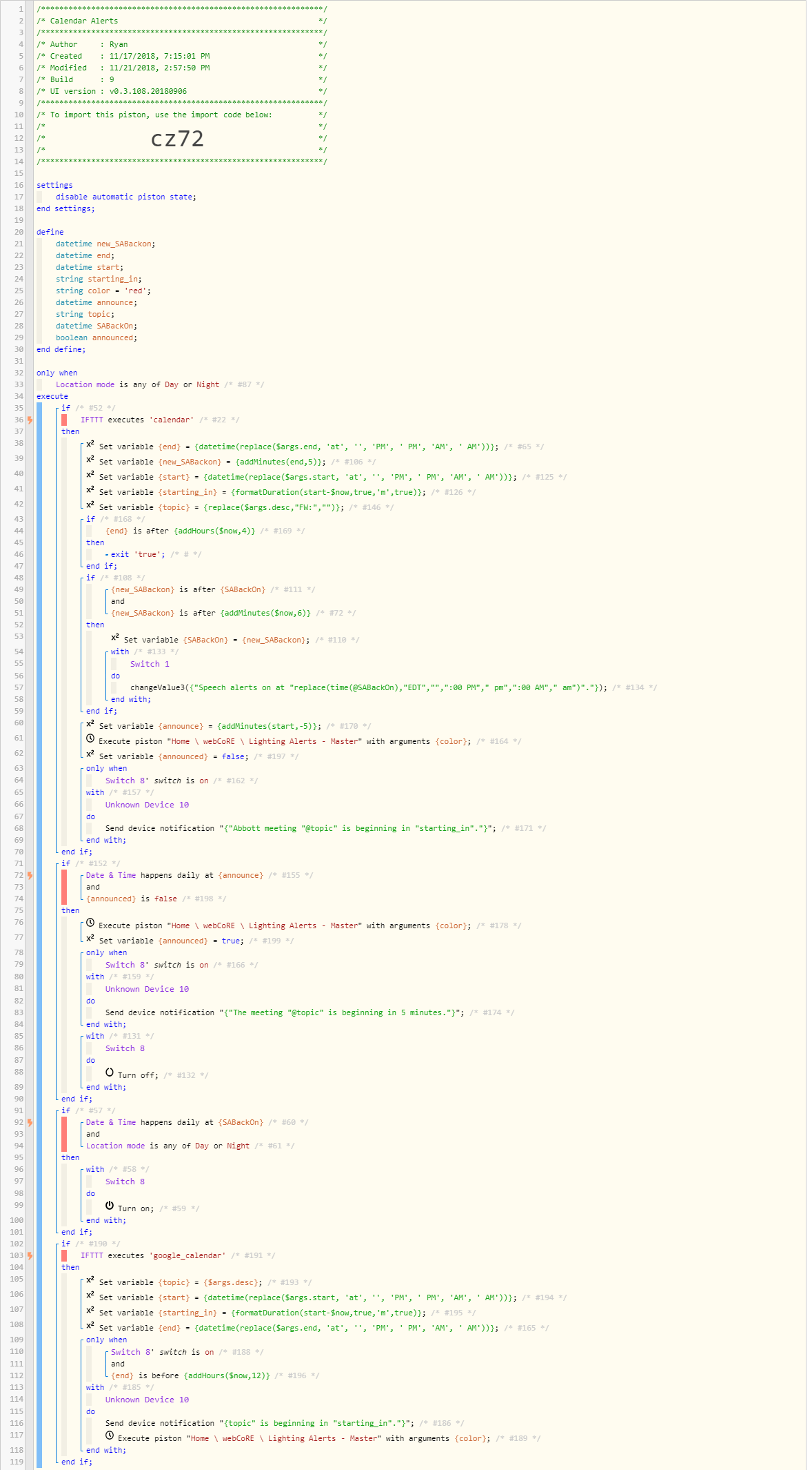

That's you...but others have had a different experience. Some of the most used automations I have rely on webCoRE to work. Nothing in the native architecture of Hubitat would be able to do it. Let me explain one....
I work from home...and when I have a conference call coming up in my Outlook 365 calendar, I get a webhook from IFTTT with the start and end times as well as the subject. That triggers a voice alert when the webhook is received and again 5 minutes before the meeting starts with the description of the meeting. In addition, LED strips I have throughout the house, flash red for 10 seconds and return to normal. Then, at the start of the meeting, all my audio alerts are shut down until the meeting is over. I have even gotten this worked out so that it accounts for a second webhook while i'm in the first meeting as well. It all runs through a few very complicated pistons that I have spent a year perfecting. Now, how could I get the same functionality through the base of Hubitat? I have adjusted my pistons to avoid the use of global variables as well as some other iffy spots I've seen in the logs but i have experienced zero issues with hub slow-downs or lockups. Plus, I don't know of any way to do those things since it involves parsing Json data and storing variables. Two functions not available in RM. Short of learning to code in Groovy, which I really don't have time to do, I don't know of any other way to get the functionality I've described in HE.

Lastly, if you are using IFTTT you could do what you are asking with multiple rules in RM. Your scenario may not be as complex as you think when you break it down. May need to use to use virtual switches or pause rules accordingly but I bet you could reproduce your scenario using HE and IFTTT. I would love to see your piston. The reason I am saying this is I used to think I could convert a VERY complex piston for auto starting vehicles dependent on if they were in the garage or not. I use a webcam to see vehicles in the garage and execute a garage door 1 or 2 open depending on the vehicle being started. I have this all running in RM with only 2 rules for each vehicle. What I thought was complex really wasn’t.
Really? But how could I parse the data from IFTTT on the start and end times? They come as JSON data in the web hook and I don't think there's any way to parse that it RM. I will post the piston when I get home if you're really interested.

For those that are interested, here's the example I was talking about. Now, I have combined a bunch of pistons into one to avoid those global variables so it's kind of long but it works very well.
