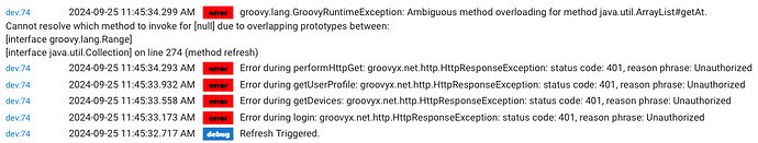

These are the errors I'm consistently getting, are these the errors you were seeing when you had the blocking issue?
I unfortunately don’t have the shark vac anymore. Looking at your logs though, you’re getting a 401, which is an unauthorized response. That means you’re hitting the endpoint, but your username and/or password is most likely incorrect.
I thought so too, but I went over to the website and tried logging in and it worked with that un/pw. I've triple confirmed it's the same I used to successfully log into the their sharkclean.com / sharkninja.com website. I also logged out of the iOS app and logged back in with that un/pw successfully. I even tried an old pw thinking maybe the API uses an old auth, but that didn't work.

I am seeing the same 401 unauthorized issue in the logs. It was working fine a week or two ago. I tried changing the username/password but no luck. Maybe something changed on the Shark side?
The unauthorized error you are seeing is very likely the same issue the Home Assistant integration encountered. Issue described in the below github thread. It seems that SharkClean has explicitly restricted authentication with the Api to just partners like Google Home and Alexa.
