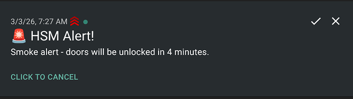

The next rule requires smart locks and smoke detectors connected to the hub. If a smoke detector goes active, multiple high priority notifications will go out to me and my wife alerting us that all the doors will be unlocked in 4 minutes. If the action isn't cancelled, the locks are unlocked after that delay. I have a second rule that is triggered by a cloud URL that will cancel first rule's delayed actions. I send the cloud URL in one of the notifications so I can abort the unlock. I decided this was a good idea after seeing what the fire department did to my neighbor's front door when they had a fire.

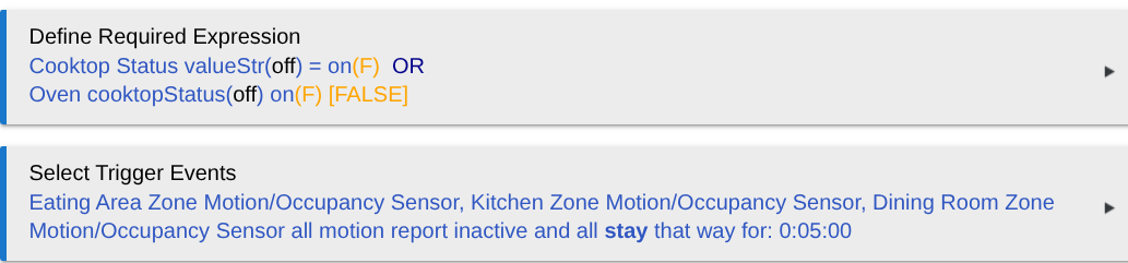

The last rule requires a smart range/oven and reliable motion detection. I recently added a connected GE range and an Aqara mmwave motion sensor in the kitchen. If the cooktop is on and the kitchen motion sensor reports inactive for 5 minutes, high priority notifications go out. That rule got added recently after we went outside to talk to a neighbor for a bit and forgot there was a pot of the stove. Nothing dramatic happened, but if the range had been turned up higher, bad things could have happened.

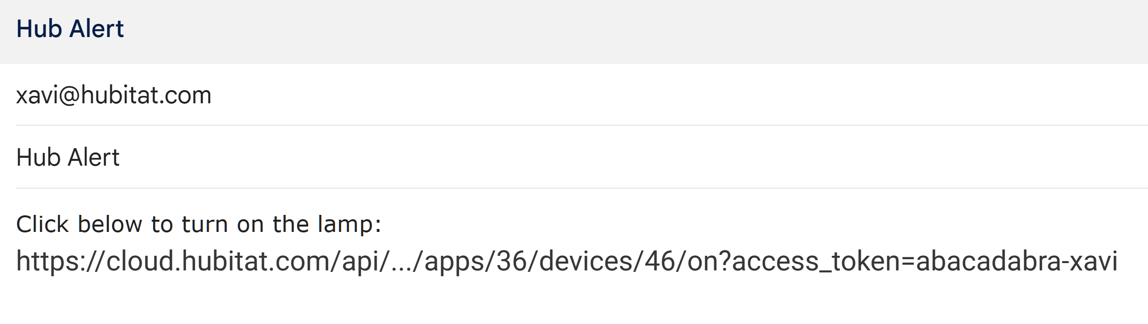

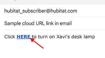

Alan can show you his example of triggering a Rule Machine routine using its "Cloud Endpoint" URL, but here's a very similar way of sending a command directly to one of your Maker API-subscribed devices using a properly configured Cloud URL embedded in an email:

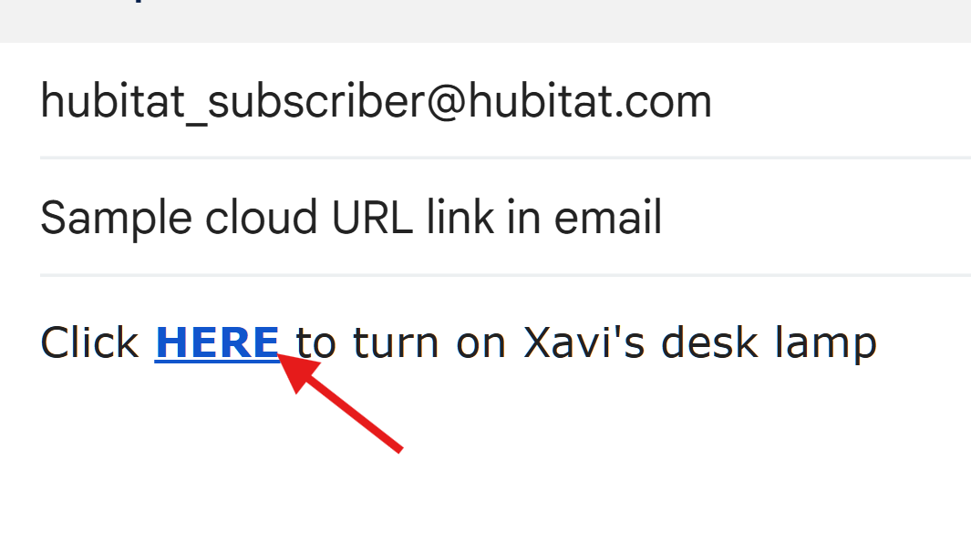

With a little extra work, you can get the outbound notification** from your hub to contain a neat hyperlink like I'm showing... but if you're content with just displaying the naked URL in the body of the email, it would look something like this:
Either way, the recipient could click (or paste) the URL to make it "go" and thus command the target device (this one turns on my desk lamp).

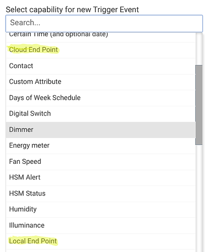

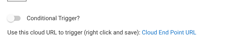

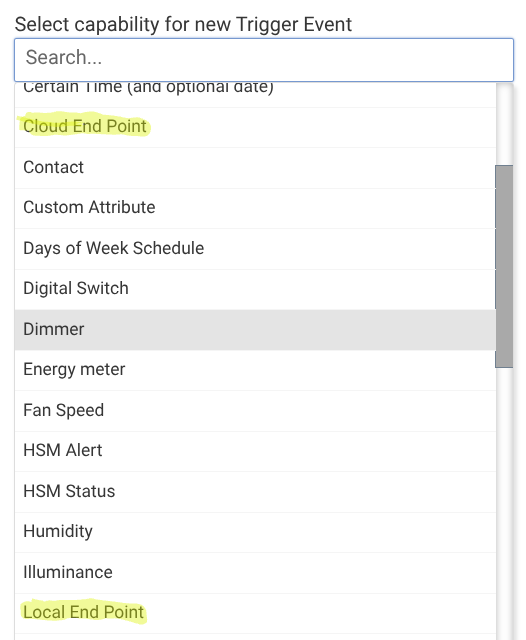

I'm not sure which part of the process you're asking about, so I'll start at the beginning. Within the rule, you can select Cloud End Point or Local End Point as a trigger.
Once you select that, it will show you a link:
You can right click on the link and copy it to add it to the notification action.

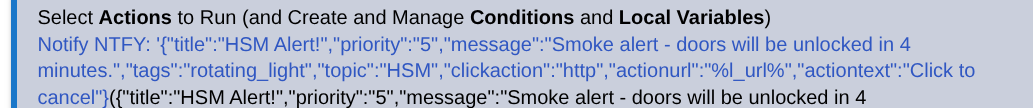

The actual notification part can be tricky because of the way HTML and links get treated in rule machine and (probably) by other apps. I am using a self-hosted ntfy server and my own enhanced version of the ntfy driver ([RELEASE] NTFY Notifier Driver - Push Notifications via ntfy.sh or Self-Hosted - #5 by Alan_F) that lets me send a structured notification in JSON format.
In the main rule, I created a local string variable (l_url) and set it to the cloud end point URL. I set my notification message to this:

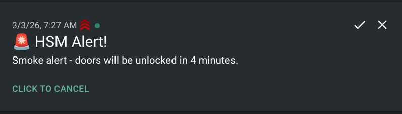

I end up with a notification that looks like this:
A similar result could be achieved with Pushover and per other posters, Tasker. I haven't had any success so far trying to send the URL via a regular Hubitat app notification (the URL comes through, but it is not clickable or copyable) or using the LGK Sendmail V3 driver to send it in an email (the link gets truncated or mangled).

Could you give details on this one? I just got a GE oven in late November and would love to copy this one. I just looked and I had notifications that oven is on but not that cooktop is.

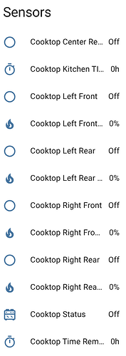

I have a "belt and suspenders" solution to this one. I have the oven connected via both Home Assistant and Hubitat, using the SmartHQ driver on HE.
HA exposes a lot more info, including the individual cooktop burners. Mine is an induction stove with 4 burners and a warming section.

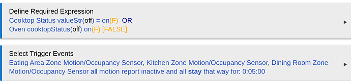

In my rule I use the cooktop status from HA and the "Oven cooktopStatus" from HE as my required expressions, then use the inactive motion detectors as the trigger. The three motion sensors are three zones of a single Aqara FP2.
I didn't even think about using the home assistant integration and I have it installed already. I was thinking you were doing it using notifications through the app. Thank you for the guidance.
