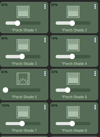

On many of my devices when I make a dashboard tile for them, it does show the battery level in the top corner. For some reasons the Shades tile doesn’t do this. My current work around is to create a different tile that shows the battery level. I would love to have the level shown in the top left corner like other tiles though.
Is there a way to do this? Everything I’ve gathered, it is not possible, but wanted to ask the question.

If you use a small grid and your tiles span multiple rows and columns, you can make a transparent attribute tile, reduce the font size, make it transparent, and remove the title with CSS. Then make the tile small and overlay it on the tile. It is a pain, and you have to be using a small grid size with spanning tiles.

Here is the solution I came up with…I did an overlay like mentioned. I then also made it so the tile will change colors based on what the battery percentage is. I just made a plain battery tile and moved it on top. This is what it looks like:
css code to get this in next post
CSS code to get the battery value and “%” symbol in top left corner and then also shade the tile based on the percentage is:
