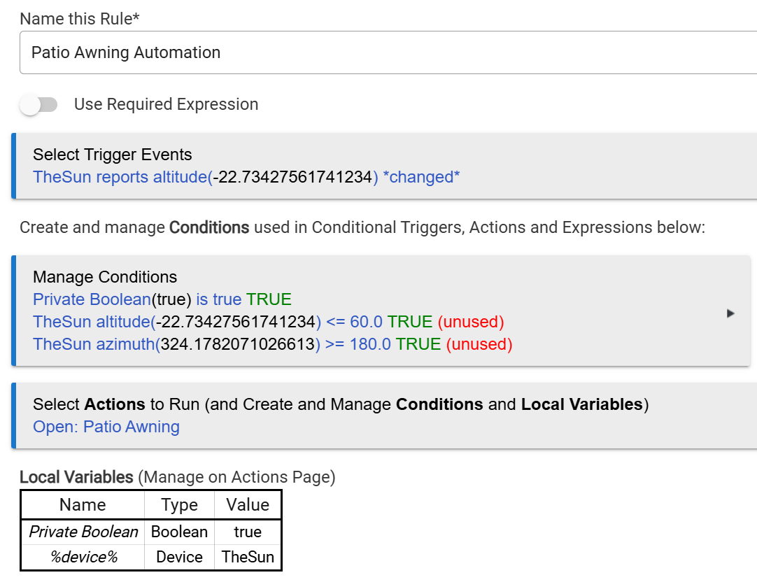

Thanks for your support so far! My brain really hurts from trying to figure all this out. I have zero coding experience. I think I'm on the right track, but when I saved my Rule my awning opened, even though it's well past sunset. Any more tips on what I'm doing wrong? Here's my Rule so far:

You've setup conditions, but you are not using them / specifying the in your rule (hence the unused label nextbto them).
In my posted example in the ā€œselect actions to runā€ i have IF statements that include the altitude and azimuth conditions. You aren’t doing this, as in your example they say unused. What you have right now is ā€œevery time the sun altitude changes, open the patio awningā€ This is not your stated goal.
Also as WAF is a consideration, it might be a good idea to create a virtual shade to test your automation on first. Testing in ā€œProductionā€ can be bad for WAF.
