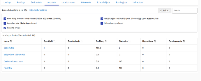

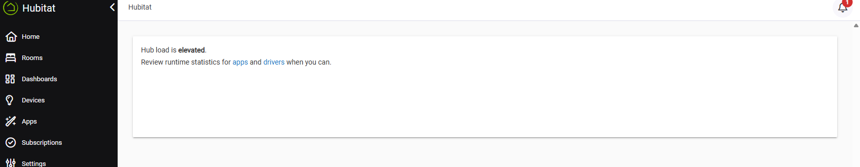

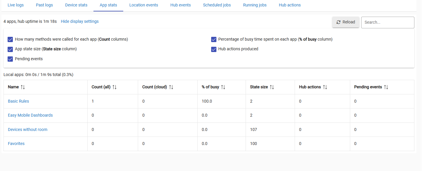

Here's some screenshots from just before the system becomes unresponsive:
