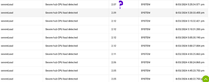

I'm logging a location event for severe overload on a regular 5 minute and 5 second interval.
I disabled every APP and that changed nothing.
I see nothing in the live or past logs that corresponds with the overload timestamps.
I've shut down the top for % of busy devices in the log.
I've shut down the last few devices I've added. (I seen this in logs before...but it would quit after 7 or 8 cycles.
Nothing stops this.
How do I troubleshoot this?

Two Q's.
Are the log messages actually spiking almost exactly every 5 minutes...or is that just when the hub reports it. I think the latter is true from another post I saw.
What is the parameter below telling me.
It is a running 5 minute average as @gopher.ny mentioned in this post:

That value is the 5 min CPU Load value as a tool like top would provide. That is why the message is being created every 5 min as it would take that long to adjust in any meaningful way. Also a high value of 2 over a 5 min interval means during that interval there were likely times the cpu was much higher.
What goes into calculating that value is complicated and doesn't directly relate to cpu usage, but is more like needed threads to process work based on cpu usage and other states the system is experiencing at a give time. This means things like waiting for storage or network connectivity can have a significant effect on the value.
What kind of value is meaningful though depends on the system's purpose, the hardware involved, and how sensitive it is to delays in processing. In its simplest interpretation you would want to keep the numeric value less then the number of threads the computer's cpu can handle. But that only accounts for pure cpu usage and not external wait states.
I have seen a system run perfectly fine when that value was consistently twice the number of threads the server could produce because of what that system did.
Hubitat with a value of 2 or greater is likely a very bad thing because we need our HA Platform to respond immediately right. As that number grows you run the risk of a small delays in automations and such.
Unfortunately it can be very hard to pin down the casuse though. You may want to look at live logging and thr zwave/ zigbee log to see if anything is causing allot of activity. You may also want to post your app and device page from the logging tab to see if anything stands out.
