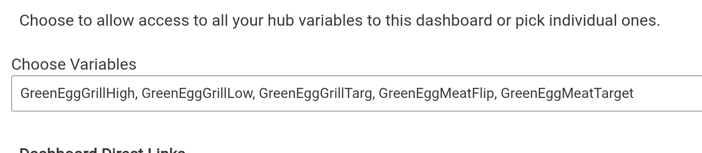

These are all HUB variables I created in Settings-> Hub Variables and the dashboards allow you to add them.
I think this is exactly what I need, thank you very much. I am new to Hubitat, so my apologies if it was a dumb question!
Not at all. I edited my comment to show what you are looking for when you create the dashboard.
