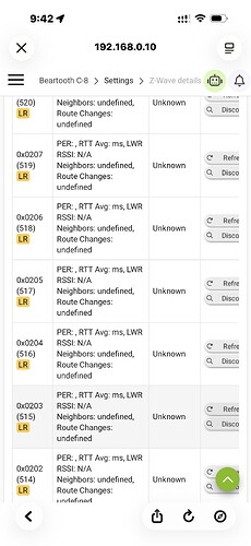

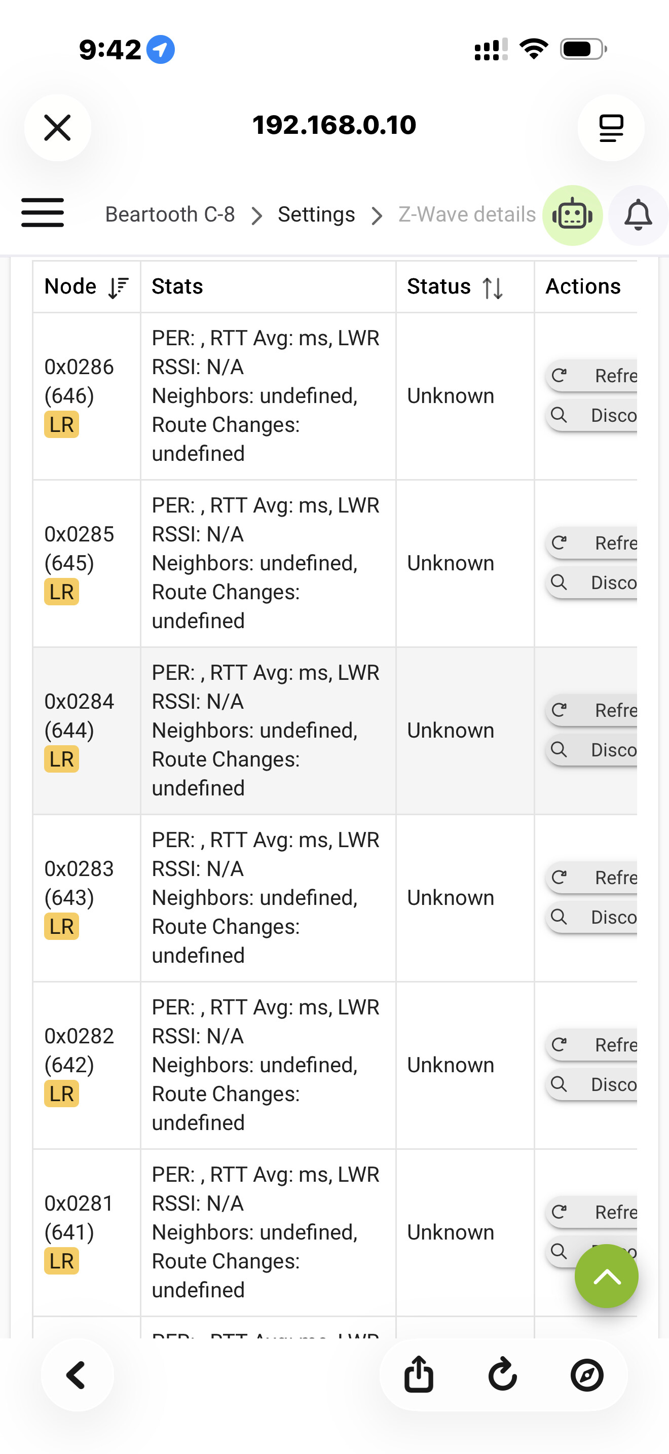

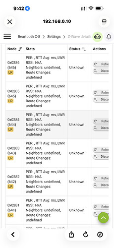

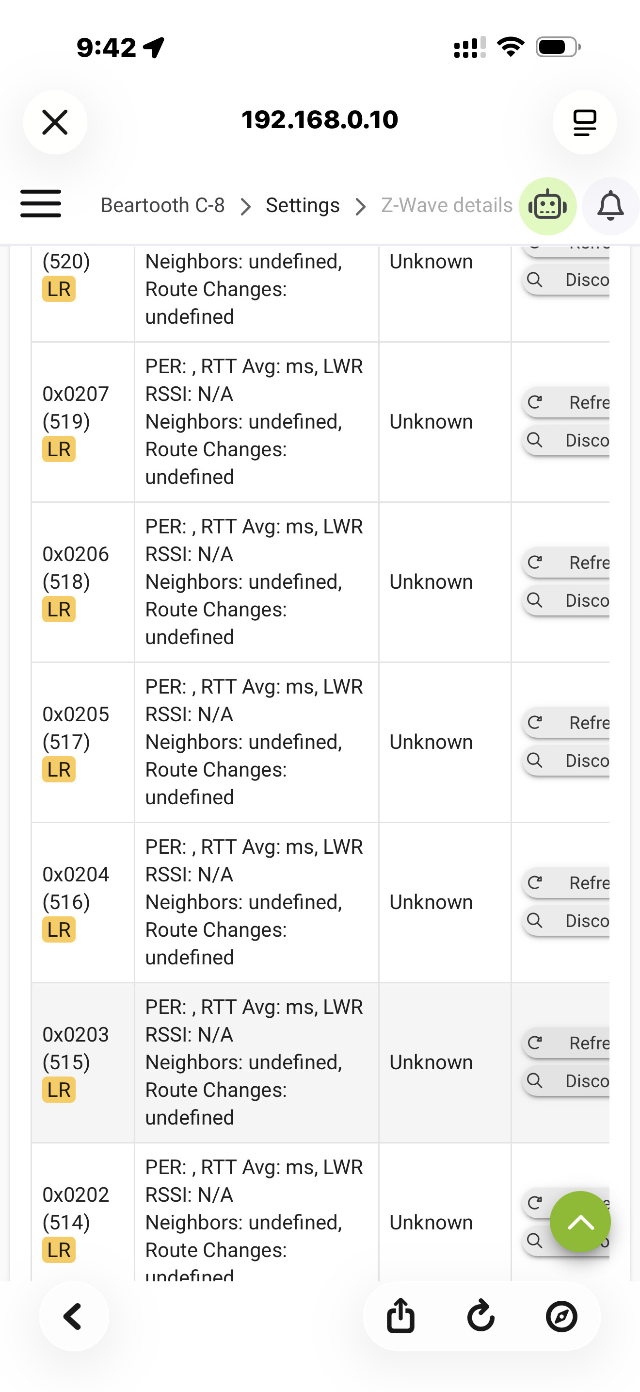

I have 114 LR devices with unknown status. I don't know why or how to get rid of them. On my Beartooth Hub. I was trying to add a smart start for a Zooz Outdoor LR 800 outlet, and I think it failed every time, adding an undefined device. I am stuck
until I get this solved.

I have 45 dervices added so far. I did not try 100 times to add the outdoor plug. I scanned the QR code and the device did not finish including. I think that smart start tried 114 times to add it and failed each time creating these undefined devices. I saw multiple attempts in the logs.
My concern at this time is why did it flood the zwave db with so many devices and will it do it again if I try to include that plug again.
