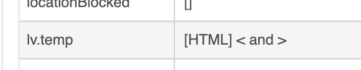

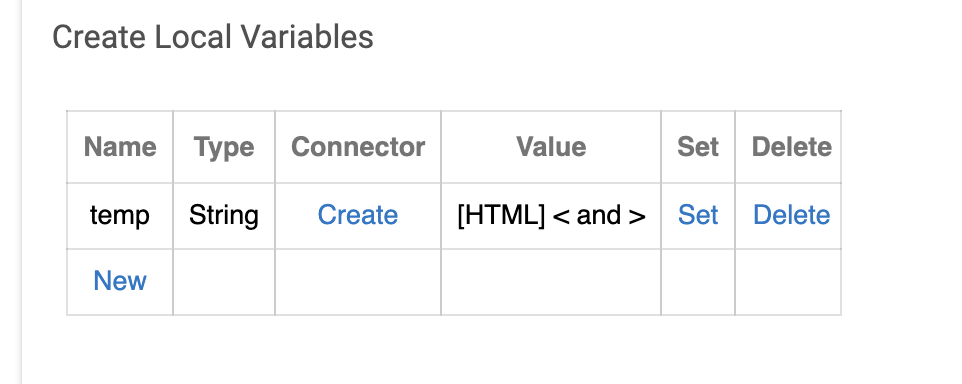

Misunderstood. To a name, no. But for the string itself, yes you can. Not sure why they are not showing in your browser. You should look at the Application State in App Status page (gear icon) to see what value it actually has. For me, it just displays it:
I think the action display is probably dropping those characters in the rendering...

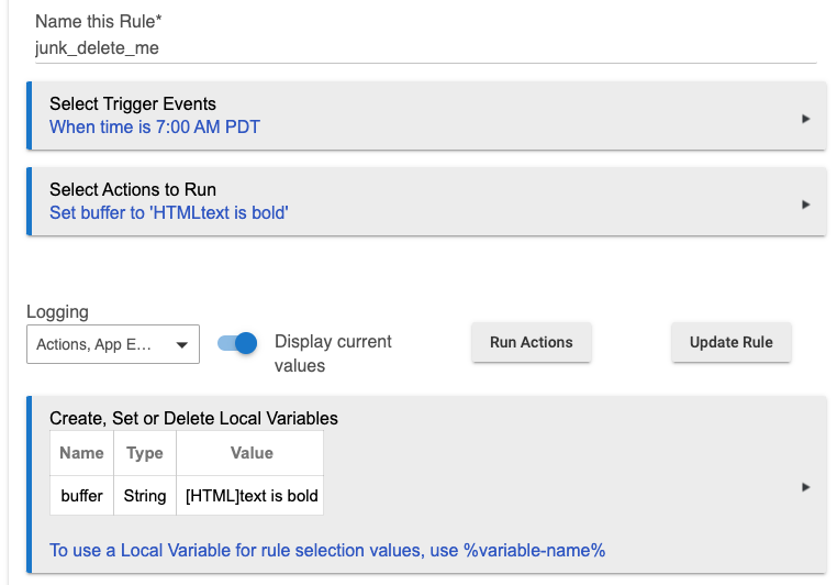

Thanks, but I can't find a way to show that Application State info. The only check of the set variable that I can see is this:
I see the [ ] brackets being saved, but the < > chevrons are not. The reason why I need these characters is for the Pushover driver. I want to use these characters so I can send Pushover HTML-formatted text (e.g., bold and colored defined text).
Click on the gear icon upper right corner of app.
From Application State. Look for lv.variable-name
Ok, I see this:

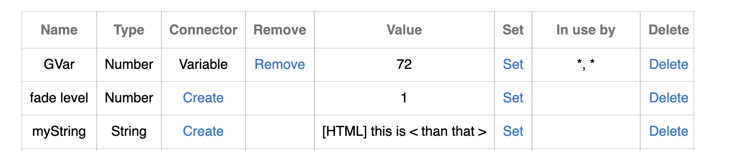

Screen Shot 2021-05-14 at 4.07.08 PM
I don't know where the embedded html you have in that string is being treated as html and where not. What I did wasn't html, obviously. But <b> clearly is.
